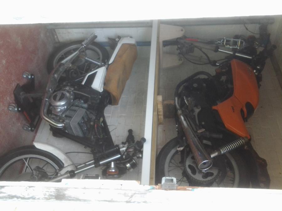

Like a lot of people I have too many toys and not enough room , even the small jobs like adjusting the chain or servicing the exup becomes a pain working in the garage sandwiched between my classic car and the garage wall, banging head and elbows on everything that gets in the way , a single garage with 3 bikes , a car ,2 kayaks , tools and various household items that shouldn't be in there anyway  :rolleyes  Is never going to work......
time to sort things out , I have a brick built shed with concrete floor roughly 7ft square , easily takes 2 bikes but very little else , the two bikes I have in there are projects that I do a bit on every now and then so I camd up with a crazy idea of a stacking system , using scaffold tube , box section steel tube , 2 winches and some decking boards , it took me a while and it is a bit tight length wise but it works    Smile      Couple of small jobs to finish off but its in use , just need to tidy the garage now

Sorry about the poor quality picture had to take it whilst standing outside the shed , lack of room you see  :lol
ill have a go at turning that piccie later aswell  :rolleyes

Great bit of engineering, have you got some sort of mechanical locks so it is off the winch when in place?

Hi chris biker , yes ,I use the two winches too get it to right height and then supported on 4 x 12mm steel rods slotted through the four uprights , just like an axle stand , bored three holes in all 4 uprights to give me a choice of heights , theres a substantial box section metal frame below the decking that takes all the weight sungly fitting around the uprights , if  the worst was to happen and a winch failed it would jam before causing any damage , tried and tested brfore putting a bike on , happy with the way its turned out and has made room for 3 bikes in the shed freeing up room in the garage...

Crikey Mr Red, that's a good bit of engineering! good work.  :thumbup

Well thank you mr hornby..........iam no engineer but I do know how to make a strong frame , woodworker by trade in the furniture industry , taught myself to weld ,still basic stuff but learning all the time , cutting the scaffold was straight forward with a angle grinder , its tight against the end walls so accurate measurement was the most crucial part of the job...

spent less than £100 on the project but has eaten into my riding time.....going to put that right this afternoon while the footies on  Wink
