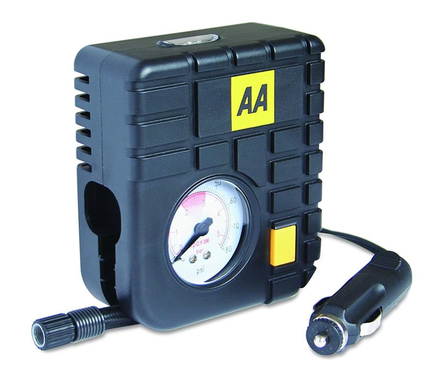

I have a mini compressor under my seat and a plugging kit. I have a 'cigarette lighter' socket installed for general charging, its compact and plugs in there.
I've never used anything else, so can't comment, but this works for me.

(25-05-18, 09:31 PM)Bretty link Wrote: I have a mini compressor under my seat and a plugging kit. I have a 'cigarette lighter' socket installed for general charging, its compact and plugs in there.
You can't pull the wool over my eyes........that's an Alcoholic Anonymous breathalyzer  :rollin
