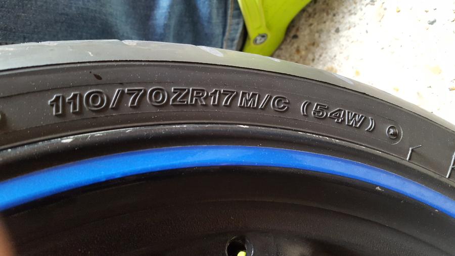

Front Tyre Question - Jbizzle - 18-05-18 Afternoon all, a friend of mine recommend the metzeler roadtec 01 tyres. http://www.metzeler.com/site/uk/en/products/tyres-catalogue/Roadtec-01 It says at the bottom of that page they do a looks like they do a 110/70 - 17 M/C 54H TL, which would be great. However, it looks like an ADV version? And it doesn't have the normal speed rating, what do you guys reckon, would it be different profile or unsafe to use? Cheers, Re: Front Tyre Question - darrsi - 18-05-18 H rated is up to 130mph. Re: Front Tyre Question - BBROWN1664 - 18-05-18 the load index is 54 and the speed rating is H Whats not normal? Re: Front Tyre Question - daviee - 18-05-18 you wont outride that tyre on a fazer Re: Front Tyre Question - darrsi - 18-05-18 (18-05-18, 07:59 PM)daviee link Wrote: you wont outride that tyre on a fazer What d'ya mean? Re: Front Tyre Question - daviee - 19-05-18 the tyre will be fine on it Re: Front Tyre Question - Arfa - 20-05-18 Interesting, when I last put a Roadtec 01 on my Fazer, I was told there was no option of 110/70 for the front. Went for the M7RR on front instead. Not ideal to go for mismatched, but the pair have performed well nonetheless. So, if this is now an option, that's good to know. Re: Front Tyre Question - Jbizzle - 21-05-18 Google it and look at the images. It looks like a different tyre, like a big adventure touring skinny tyre. So although it fits, and has enough of a speed rating, could the profile be significantly different? Its almost like they are selling it under the same brand name but from a different mold for a different application. Thoughts? Re: Front Tyre Question - BBROWN1664 - 21-05-18 Jbizzle, post a link for the images you are seeing. I cant find anything other than motorcycle tyres (the m/c in the size means this). The size 110/70 - 17 M/C 54H TL breaks down like this. 110 - The width of the tyre 70 - 70% of the width is the profile 17 - The rim size m/c - motorcycle specific 54 - the load rating (the code for the weight it can take ) H - The speed rating TL - Tubeless Re: Front Tyre Question - Jbizzle - 21-05-18 Gents, Apologies! I think i may have been confusing it with this https://www.demon-tweeks.co.uk/Product.do?method=view&n=5769&g=1469912&p=1469920&d=124&c=4&l=2&utm_source=Google&utm_medium=Base&utm_campaign=Classic%20/%20Commuter%20Tyres&gclid=Cj0KCQjw3InYBRCLARIsAG6bfMTPxV4vuxGUwC3UCtqJA2HHPDTk8H-BgPTAnfPBvBdB2iW8nBRDjm4aAnj3EALw_wcB&gclsrc=aw.ds Re: Front Tyre Question - Gnasher - 21-05-18 (18-05-18, 03:31 PM)darrsi link Wrote: H rated is up to 130mph. H rating isn't high enough for a Fazer the rating should be ZR or Z over 149mph H is too low. [/size]Yamaha state ZR as OE, it's possible if you are involved in a RTC your insurance company might well claim the bike isn't as designed and use it as an excuse not to pay or withdraw your cover. [size=78%][/size] Re: Front Tyre Question - darrsi - 21-05-18 (21-05-18, 03:22 PM)Gnasher link Wrote: [quote author=darrsi link=topic=24160.msg280108#msg280108 date=1526653881] H rating isn't high enough for a Fazer the rating should be ZR or Z over 149mph H is too low. [size=1em]Yamaha state ZR as OE, it's possible if you are involved in a RTC your insurance company might well claim the bike isn't as designed and use it as an excuse not to pay or withdraw your cover. [/size][/quote] Yeah, the only reason it stuck in my mind was 'cos my old NTV was H rated. I've only ever bought ZR for this bike. On the subject of insurance, without meaning to go astray, i paid for a renewal earlier today and they said as my bike is classed as garaged at night if anything happens to it within 500 metres of my home and it's not garaged then they won't pay out. So if i want to stop at the local shop on the way home from work i suddenly have invalid insurance if it's nicked? Modern day Dick Turpin's. Re: Front Tyre Question - tommyardin - 21-05-18 (21-05-18, 01:20 PM)Jbizzle link Wrote: Gents, Apologies! I think i may have been confusing it with this Re: Front Tyre Question - tommyardin - 21-05-18 Best tyre I have ever had on the front, by far, the Battlax T30 Re: Front Tyre Question - Arfa - 21-05-18 http://www.metzeler.com/site/uk/products/tyres-catalogue/Roadtec-01.html Metzeler's site shows quite a different tread pattern from front to rear version of Roadtec 01. And they list the 110/70 54H. No ZR in this size... Re: Front Tyre Question - tommyardin - 21-05-18 (21-05-18, 06:31 PM)Arfa link Wrote: Re: Front Tyre Question - BBROWN1664 - 25-05-18 (21-05-18, 01:20 PM)Jbizzle link Wrote: Gents, Apologies! I think i may have been confusing it with this From the link The Metzeler Roadtec 01 X-Ply is designed for lightweight and classic motorcycles, Added to the lack of the ZR tyre tells me enough to say not to fit this tyre to a Fazer |
