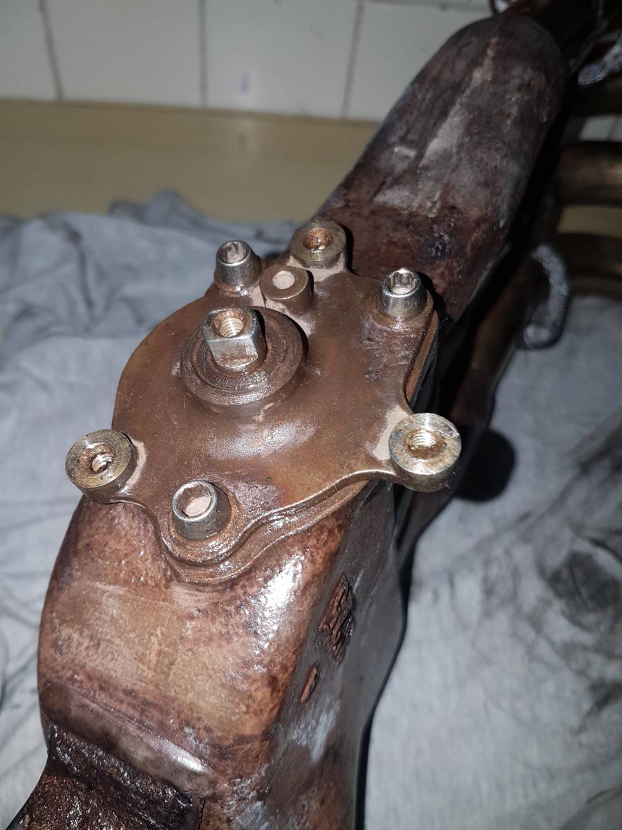

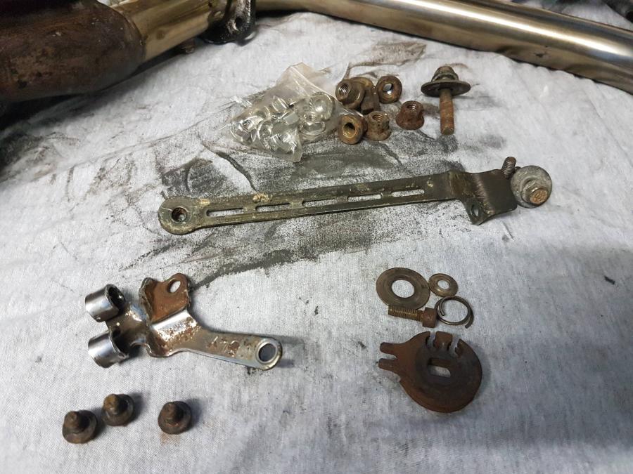

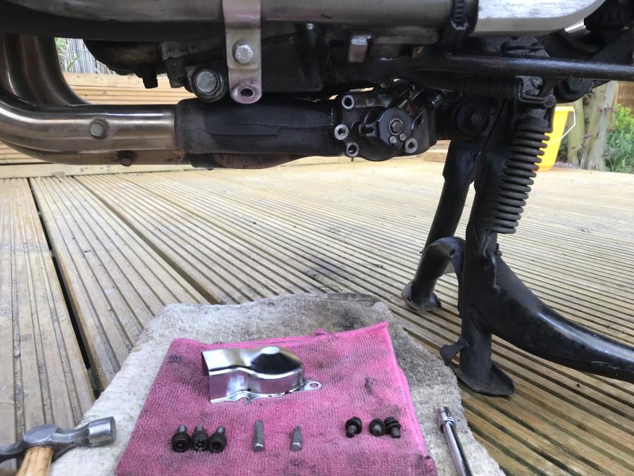

Re: EU to UK headlight reflector swap, any advice appreciated. - b1k3rdude - 02-05-18
(21-04-18, 09:51 PM)b1k3rdude link Wrote: Do yourself a favour and replace those 3 stubby bolts with titanium, they can be found cheap enough and it will save you a lot of stress down the road.
Just serviced mine, and should have said replace 6, because here is what mine look like -
The first pic starting at the top, is of the header bolts, rad bracket and then all the exup bits
Then after I had cleaned up the exup valve parts, see the 3x titanium allen bolts they are the ones that snap. I will be replacing the 3x stubby M6 (8mm head) bolts with titanium in due course. The rusty rad and exup cable brackets and pully were treated with Hammerite Kurust
