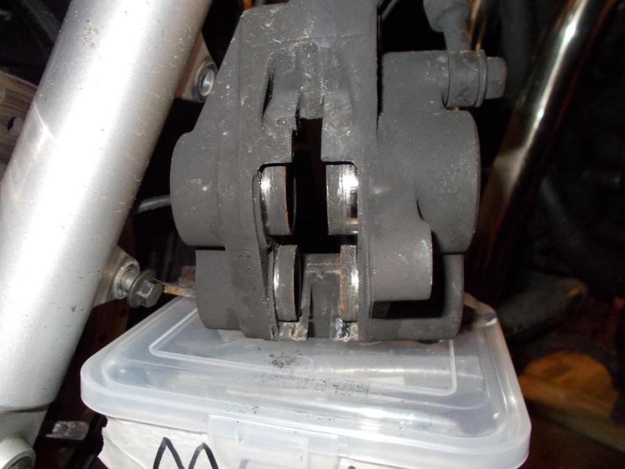

Started this afternoon with the front brakes, as I'd noticed /something/ was dragging when rolling it into the shed yesterday. Both calipers had the usual layer of dirt on the pistons, most of it came off easily. There's minimal pitting (as far as I can see) on only some of the pistons. Front brakes are still binding (mainly the left one I think), so a new set of seals, maybe some pistons and a proper rebuild of the calipers will be in the near future.

Not to sound negative in the last post though, still happy I bought it Smile

The centre stand gets a beating from the spray from the back wheel so very common to see them like yours. Well worth taking the time to clean it up and giving a good coat of paint occasionally as they have been known to rust through and can be hard to find/expensive on ebay.
The rear caliper is something I should have mentioned. Being under-slung it tends to collect spray etc. and I try to give the pistons a bit of clean each year and put a bit of red rubber grease on them. After cleaning the bike i blast any water away with an air line as it tends to collect at the bottom, or take it for a spin. I get the impression you're well capable but will just mention that if you do change the seals make sure you carefully clean out and crud in the seal groves otherwise the pistons will still be stiff.
