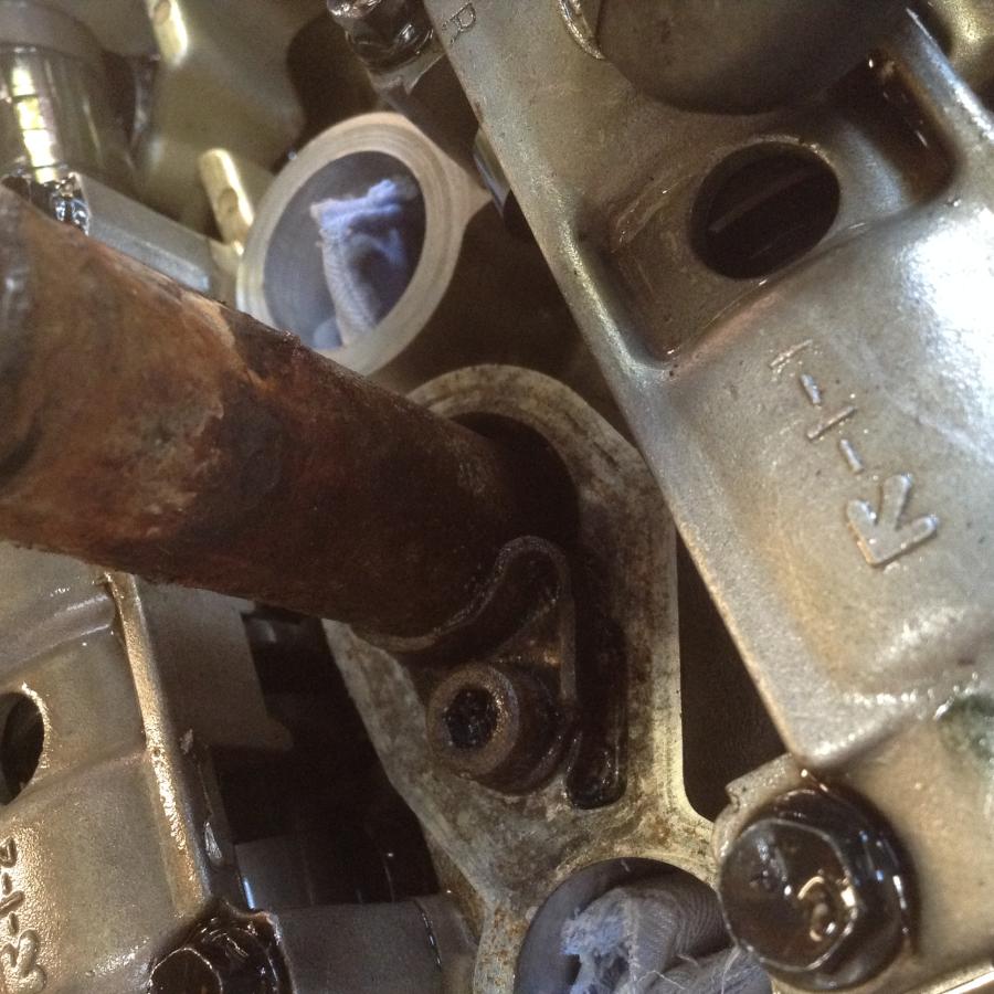

Re: Winter maintenance time - Trebus - 10-01-18 Reading this made me think back to what I’d used. Last night I couldn’t for the life of me recall even though it was only a few months ago! But I now do; a walking stick rubber! It fit an absolute treat and almost looks OEM. Re: Winter maintenance time - tommyardin - 10-01-18 (10-01-18, 09:18 AM)Trebus link Wrote: Reading this made me think back to what I’d used. Last night I couldn’t for the life of me recall even though it was only a few months ago! But I now do; a walking stick rubber! It fit an absolute treat and almost looks OEM. You go steady when you go out walking now you old bugger with the tip missing off your walking stick :lol Mind you it is better its only the tip of your walking stick that's missing :eek Re: Winter maintenance time - Mustang - 10-01-18 Got the cam over off and greeted by the horrors around the bottom of the water pipes, grit and mess. Managed to pick out as much crap as I could before leaving it to dry, see if I can vacuum out the rest. I've bought some new o rings for the seals on them, does anyone take these out for cleaning, painting , etc? Also had to shell out for a new cam over gasket as Yamaha make the spark plug seals one piece with the cover, that's a rip off. Just started the valve clearance check, done no 1 cylinder, will post up readings for comment later. Re: Winter maintenance time - Mustang - 10-01-18 Pics Re: Winter maintenance time - Mustang - 10-01-18 Checking these clearances, I think I need 11 to bring the tight ones up a bit. Re: Winter maintenance time - Mustang - 10-01-18 Cams out and shims measured one by one. All factory shims I recon, never been done before. Now I need another gasket for the cam chain tensioner! Why not an O ring ffs. Much easier on sportsbikes, this has so far been more awkward. Re: Winter maintenance time - Andy W - 10-01-18 Glad you're having fun! :eek I was lucky, my valve clearances were all fine. :woot It'll all be worth it in the end!
Re: Winter maintenance time - Mustang - 10-01-18 Managed to swop some around on paper anyway , so I've ordered the rest plus a couple of spares. I struggled getting the feeler gauges in as I had to combine 2 thin ones for example 0.11mm, needs a 0.05 and 0.06mm. They don't have as much rigidity as a single blade. Re: Winter maintenance time - Mustang - 11-01-18 Cam cover gasket and water pipe o rings arrived today, good old Fowlers. While I'm waiting for the shims to arrive, I've pulled the water pipes and cleaned them up. The old o rings were shot, hardened and locked in with corrosion so all that got scraped out of the head and cleaned up. Pipes wire brushed and got a lick of silver hammerite. NEw o rings greased up and slipped over the pipes and refitted with new stainless bolts. Pipes were quite corroded at the top, hope they don't leak. Although you can pull these pipes out without removing the cam cover now I see how it all goes together. Old cam cover gasket removed, there's a world of difference with a 15 year old seal compared to a new one. Tried to remove the flaking paint from the cam cover with nitro ours but it's not very effective, so I did my best with scraper and scotch pad then wet n dry. Blew it over with simonize engine enamel. Tidied up the radiator mounts as my bike was a write off it has a non standard rad, so the fan was only held on with one bolt and a tiny fixing under another. Fabbed up some adaptor plates and now have 3 mounts. Took off the coils and cleaned up the earth mounts, quite a bit of rust going on there. Re: Winter maintenance time - tommyardin - 12-01-18 Hi   Just asking a question really. You say you have greased up the new O rings and have put them back in place, just wondered what you greased them up with? Ordinary mineral grease will attack rubber and cause it to deteriate much quicker than Silicon grease or Red Rubber waterbproof grease, you should not really use mineral grease in this situation for the same reason as you would not use it on calliper pistons. (Rubber seals) The other thing worth doing is when fitting new gasket to engine cases or covers, is to lightly smear one of the mating faces with a jointing compound and the other side with grease, the next time the cases come apart the gasket will not tear as it will stay on the jointing compound side and the greased side will not stick to the other because of the grease, it will just stick to one side of the joint, save a fortune in gaskets and also the time waiting three days for the replacement gaskets to arrive from eGay. Just a thought Re: Winter maintenance time - Mustang - 12-01-18 @tommyyardin, Thanks for asking. Of course I Used red rubber grease, but thanks for showing some interest in my post. The o rings themselves appear to be some special compound being a darkish red colour, perhaps viton? This must be for high temperature operation as normal epdm rubber would have cracked and the old ones came out in one piece, so they were well worth the £2 each I think. I'm always wary of putting grease on gaskets as it can cause them to 'spread', mind youI can't see that happening with a hard paper type seal, I will [size=78%]try that with he oil pump cover and cam chain adjuster ones.[/size] [/size] Re: Winter maintenance time - cl1ve2004 - 12-01-18 Blimey reading this post makes me think I should be doing mine ..she's up to 27k now... :eek I feel the urge :evil Re: Winter maintenance time - Mustang - 12-01-18 (12-01-18, 10:08 AM)cl1ve2004 link Wrote: Blimey reading this post makes me think I should be doing mine ..she's up to 27k now... :eek I feel the urge :evil Once you start its not so bad, I have a car and another bike which makes it easier. Its pretty daunting if you've not done anything similar before, but well within the home mechanics ability. Sportsbikes are a lot easier - tank off, airbox off, cam cover, bang - your there. My valves were almost all just in spec so at 27k you might be ok, but look at the state of the water pipes, etc, its time on the road that matters and winter/wet riding. . - Mitch - 12-01-18 . Re: Winter maintenance time - Simon.Pieman - 12-01-18 Nothing wrong with checking the valve clearances, but (if you search the forums) on these engines there's only a very small chance that they need adjusting during the life of the bike, even at 100,000 miles up. I checked mine for the first time at 91,000 miles but only because I had the cambox cover off for painting, all were well inside tolerance. I think one women in the states had just one exhaust valve reshimmed after 200,000 miles and then only because it was close to tolerance -but not actually out. Don't sweat it if you put off checking valve clearances, they are probably fine. Re: Winter maintenance time - Dustydes - 12-01-18 Does anyone have a blanking cap for the airbox I could buy? I measured and used these, dropped in hot water and fitted. Nice and tight fit. https://www.ebay.co.uk/itm/Ferrules-External-Plastic-End-Caps-Rods-Chairs-Feet-Cable-Wires-Protector/222046375892?hash=item33b2fecfd4:m:mrEnUAEkR4pRM03zkoeI3uA Re: Winter maintenance time - slappy - 12-01-18 What size blanking cap do you need? I have a couple of blanking caps that might fit, if you pm me your address I will post them to you for free. Re: Winter maintenance time - Mustang - 12-01-18 (12-01-18, 10:35 PM)slappy link Wrote: What size blanking cap do you need? I have a couple of blanking caps that might fit, if you pm me your address I will post them to you for free.Thanks mate ill do that  |
