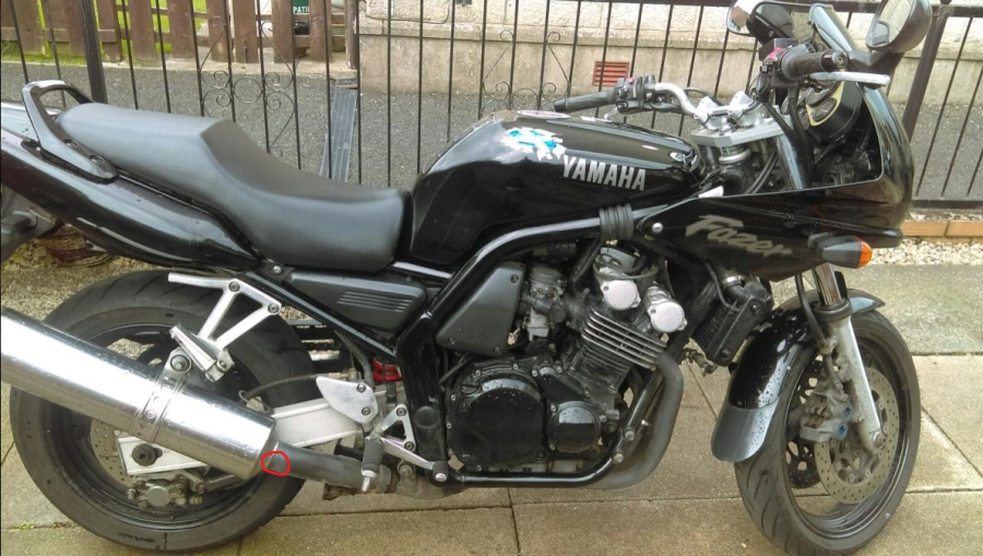

I was going to suggest changing the plug caps for NGK SD05F ones as the originals tend to break down and cause misfiring, but looking at your photo it seems rather non-standard… is that a coil-on-plug mod?

looking at the pic i dont think thats a coilpack mod as the wire thickness still looks HT size - but they do look a bit different from a standard setup

Two things, firstly those plug caps don't look standard, in fact I know they are not.[/size]

Cheers for the input, have a new air filter arriving Saturday and found a small hole/leak at base of the exhaust will get that fixed and not look at anything else until I've tried it with the new changes then I'll make a note of things/try one thing at a time. If all that fails I'll just have a mechanic look at it, I'm still a novice at the maintenance side but learning a tonne.

when you say small hole at base of exhaust - do you have the factory exhaust on there and do you mean at the lowest/most forward part of the silencer - i think that one is meant to be there for drainage - i noticed that hole once i realized how fucked the insides were as i was getting a lot of escaping gasses through it
Re: Starting/Running Issues - Fazerider - 07-12-17
Note that there is meant to be a drain hole at the bottom of the exhaust can. It’s there to drain condensation out.

I'm aware of the drain hole, this is a different hole I can see exhaust fumes firing out of it just as the base of the can itself

(07-12-17, 09:16 PM)Disorderlypunk link Wrote: when you say small hole at base of exhaust - do you have the factory exhaust on there and do you mean at the lowest/most forward part of the silencer - i think that one is meant to be there for drainage - i noticed that hole once i realized how fucked the insides were as i was getting a lot of escaping gasses through it
Hole is around there, and yes it's the factory exhaust.

The innards of the silencer are mild steel and rot through at the base so the gases can blow out of the gap around the pipe where it enters the stainless can. You may be able to bodge it by squishing in as much high temperature silicone sealant as possible. I got a couple of extra years life out of mine that way.
Having said that, I doubt it’s the cause of your running issue which sounds much more like an electrical problem to me.

why did i not think to look at the pic that stares me in the face everytime i look at this post lol
yeah that is a hole hole not a drain hole - assuming you put the red circle in the right place and not trying to mess with our heads
bit of gun gum should solve a little problem there - no point paying a guy to weld up a hole on an exhaust that is hitting the end of its life
but as fazerider just pointed out - it aint your running issue as i have run with no pipe at all without a problem
