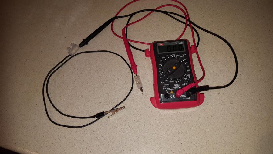

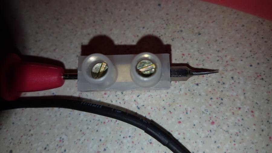

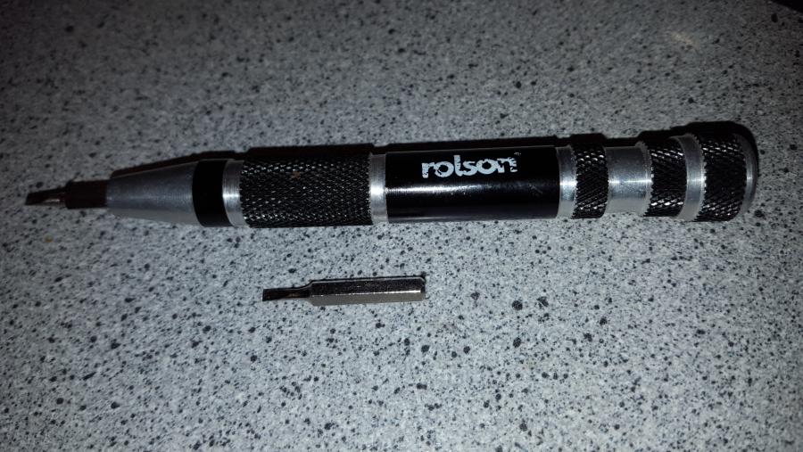

Home made Prick Pen circuit tester:
2.  Single Chocolate Block Connectors.
1.  Crocodile Clip.
1.  Jewellers Screwdriver Bit.
1.  Length of Wire (Preferably Black 2'6" Long)
Tools Needed:
Fine file to sharpen the Jewellers Screwdriver bit to a point.
Soldering Iron to solder the Crocodile Clip to on end of the length wire and to tin the other end.
Can be used to check if a wire
has current, can be used to find the point where the break is by checking along a wire length.
Can still be used as a normal Multi-Meter to check continuity and resistance. Undo the two screws that grip the probes and your back to a standard Multi-Meter  The Screwdriver bit I used was from a Rolson Jewellers mini screwdriver purchased from Robert Dyers, it comes with about 8 or 9 bits held within the body of driver
The rest as they say is!        See pictures.

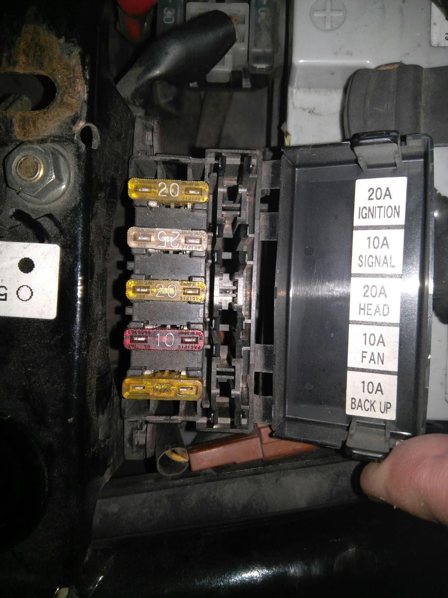

Not convinced myself that it's just water damage as plugs are melted,why is there a 25 amp fuse where a 10 amp should be.  [img alt=Shocked]http://foc-u.co.uk/Smileys/efocicon/shocked.gif[/img]
Re: Bike doesn't turn on / no lights - celticbiker - 19-11-17
Doesn't look like water damage to me either. Looks more like a short circuit or high current load causing the connector to overheat.
I guess if the connector spades are badly corroded it could cause a high resistance and result in what you see.
It's possible that the previous owner had fuses blowing because of this so just chucked in a big fuse to get around it.
After repairing this problem I would suggest checking all the other connectors and cleaning with Duck oil (not wd40) or acf 50 to prevent any future problems.
Re: Bike doesn't turn on / no lights - Fazerider - 19-11-17
According to the wiring diagram for the 02 model, the ignition fuse is 20A.
It doesn’t look to me as if water was involved: that plug carries power for almost everything, including the headlights, so the currents are quite high. If the connection is not making very tight contact this will result in overheating.

(19-11-17, 12:38 PM)Fazerider link Wrote: According to the wiring diagram for the 02 model, the ignition fuse is 20A.
You're right, I was thinking of the signal fuse, not the ignition one. So I guess you've debunked my theory ahah, nothing to do with fuses
Here's how the fuse box was (25A fuse on 10A signal)
