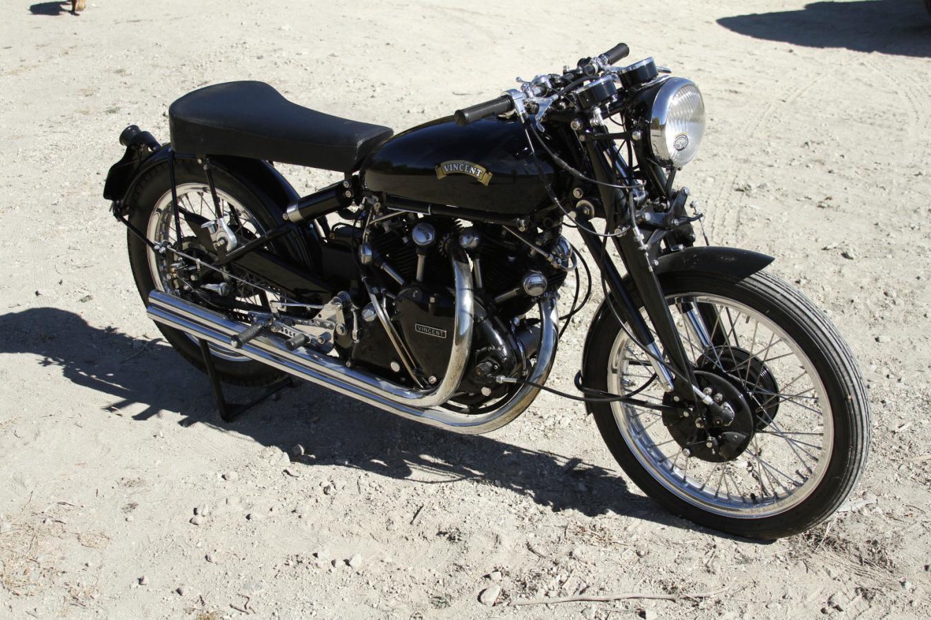

Oh! by the way I love the look of the Vinny.
I generally was a BSA man and loved the BSA Super Rocket and Road Rockets with their A10 650 parallel twin pot engines and remote gear boxes with a primary chain.
The pictures below are grab shots from Google Images and not my bike.
I did not take many photos then as you had to carry a foccing great big Kodak Box Brownie camera around in your pocket use up 12 or 15 frames then send them away to some obscure company up in the midlands, then wait 2 or 3 weeks to get back 5 reasonable pictures back, one my have your thumb in one bottom corner, two out of focus with a bright orange flash down one side (What the fuck did cause that?) and a lovely picture of up your own nose.
