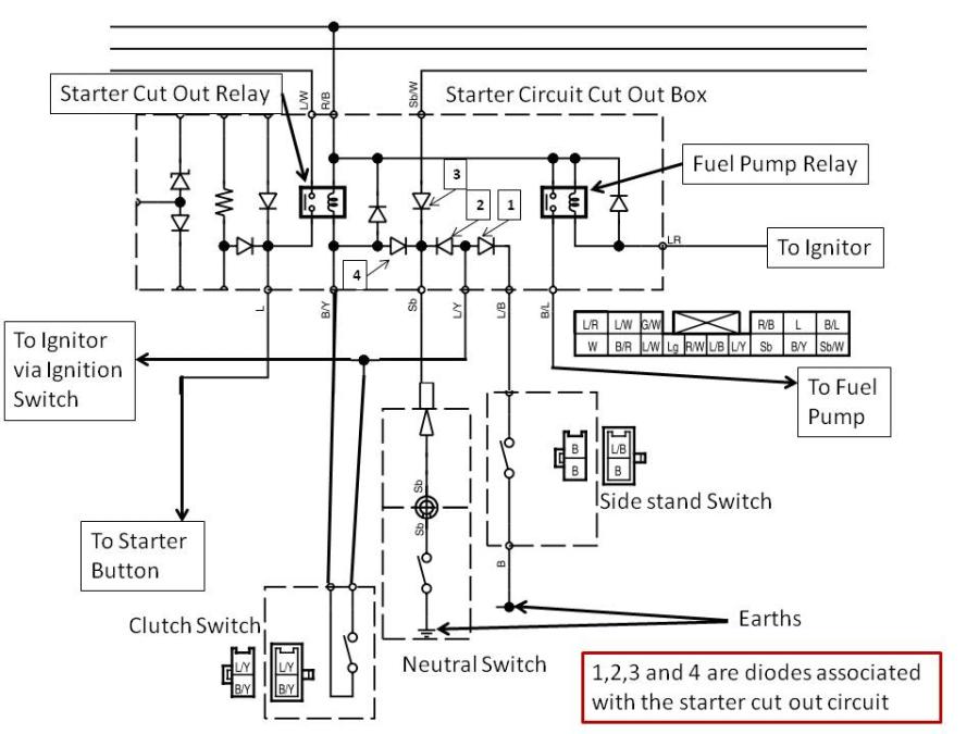

Re: Interlock - Dustydes - 16-08-17 Thanks reggit will check tomorrow. (16-08-17, 05:44 PM)reggit link Wrote: Mine starts (there's an improvement!) in neutral with the clutch out. Re: Interlock - unfazed - 16-08-17 Just a quick note on how this works, :lol Side stand and Neutral switches. The side stand in the up position a switch closes and sends an earth through a diode (1) via the ignition switch to the Ignitor, wiithout this earth the Ignitor will not fire the plugs. With the side stand down the earth which operates the neutral light switch, is now used instead to keep the bike running, when the bike is in neutral an earth is sent through a different diode (2) via the same circuit in the Iginition switch to the ignitor. The neutral light operates through a different diode (3) to prevent back feeding 12volts to the starter cut out circuit. But this is only part of the setup These earths are also sent to the Starter cut out relay and without one of these earths the starter cut relay will not operate and the Starter solonoid will not operate therefore starter motor will not turn. Therefore with the bike in gear and the sidestand down these earth are missing bike will not start even if you try bump starting it with the side stand down it will not start. Starter solonoid and Starter cut out relay When the bike is in neutral the earth is sent through a different diode (4) to the starter cut out relay thus operating the starter cut out relay which in turn allows the Starter Solonoid to operate and turn the starter motor. However with the sidestand up and in gear, when you pull in the clutch lever the clutch switch reroutes the earth from the sidestand switch to the Starter cut out relay and the Starter Solonoid will operate because it bypasses diode (4) It appears in you case since the Neutral light works and the bike will only start in neutral with the clutch pulled in would appear that diode 4 is knackered. To test this diode take note of where the Black/Yellow and the Blue wires are connected and put a meter accross these pins and note the reading, now reverse the leads on the pins and note the reading. If the diode is working then you will have continunity or very low resistance one way and no continunity or very very high resistance the other way as the Diode allows current flow in one direction only. For easy remembering when following wiring diagrams positive flows in direction of the Diode Arrow. There! now you know :lol If it is the problem and since these are not repairable and are not a common failure, second hand ones should be easy to come by. The same one is fitted to the early carburettored R1s, R6s and all the Fazer 1000s. It is possible the failure was caused by careless removal of the alarm. See attached Picture Re: Interlock - characticus - 16-08-17 It appears in you case since the Neutral light works and the bike will only start in neutral with the clutch pulled in would appear that diode 4 is not knackered. Excellent write up though ... Re: Interlock - unfazed - 16-08-17 Characticus, Thank you, well spotted, corrected now :thumbup Was going to write "not working" but knackered sounded better and changed it, but forgot to remove the NOT :lol Re: Interlock - Dustydes - 17-08-17 Thanks for the indepth replys. Just to add but was left out as it might have caused some confusion at start. Whoever tried to sort this did so by unplugging side stand switch and bridging wires. So in this state the bike will start but can be ridden with side down as no switch. By relay you mean the starter relay that connects direct to + on battery. Re: Interlock - unfazed - 17-08-17 The unit that connects directly to + on the battery is the solonoid this is a relay with very large contacts, but since the starter motor turns and the bike starts the solonoid is ok. Bridging the wires as on the unpluged sides stand is the same as having the side stand up when connected normally as it is just bypassing the side stand switch, which is why the bke could be ridden with the side stand down. Not recomended :eek The unit I believe you need is the biggest box under the left side panel, officially known as the Starting Circuit Cut Off Relay and the part number is 5EB-81950-20. Some sellers call it the Fuel Pump Relay because it contains the Fuel Pump Relay :eek . I would try some where like Fazerspares or put a wanted ad in the for sale section. Be aware a brand new one in Fowlers is £47 + Vat, so don't get conned to paying silly money for a second hand one Re: Interlock - Dustydes - 17-08-17 Thanks unfazed Got it, did think it was fuel pump relay. As for alarm guessing wires are ok? I have all black no plugs, so cut off. 1 marked LH indicator not connected 1 marked RH indicator not connected 2 wires joined marked clutch circuit 2 wire joined marked starter circuit 1 marked earth not connected 1 marked +12V not connected 1 unmarked Re: Interlock - unfazed - 17-08-17 1 marked LH indicator not connected Connected to the alarm via diode. Allows the indicators to flash when alarm activated, 1 marked RH indicator not connected Connected to the alarm via diode Allows the indicators to flash when alarm activated 2 wires joined marked clutch circuit Name doesnt sound right usually the kill switch or side stand switch circuits 2 wire joined marked starter circuit Sounds right disables the starting circuit 1 marked earth not connected Earth for alarm 1 marked +12V not connected Could be the switched 12v or pernament 12v for the alarm Check if this remains on if Ignition switch is off 1 unmarked Could be the switched 12v or pernament 12v for the alarm Check this to see what it is. Diode prevents back feeding to the alarm when Indicators are operated normally. |
