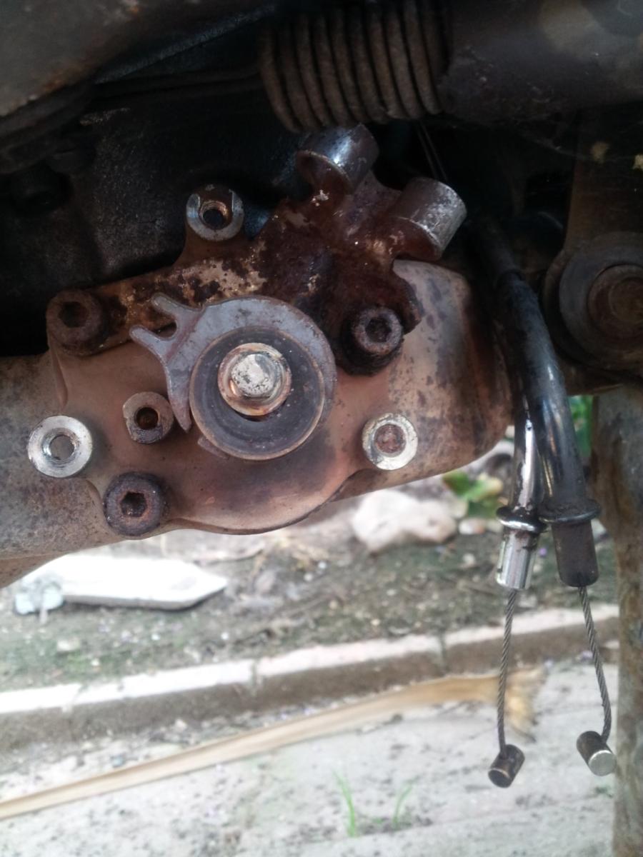

Here is a couple of pics.
The valve is stuck, the servo is there and plugged in. Not run to see if cables move when revved.
There is no movement of the rev counter needle when ign is turned on.
Re: A bit of advice needed for new owner. - Dustydes - 02-06-17
Looks good, there should be another bush on the end one small on larger, check to see if its stuck it exhaust.
Make sure cables move freely, run some 3in1 down them.
If cables are totally knackered send me a msg I can link you to parts to replace inner very cheaply.
Have you got the servo motor in place and plugged in, if you have and its working you wont get servo fault on rev counter.

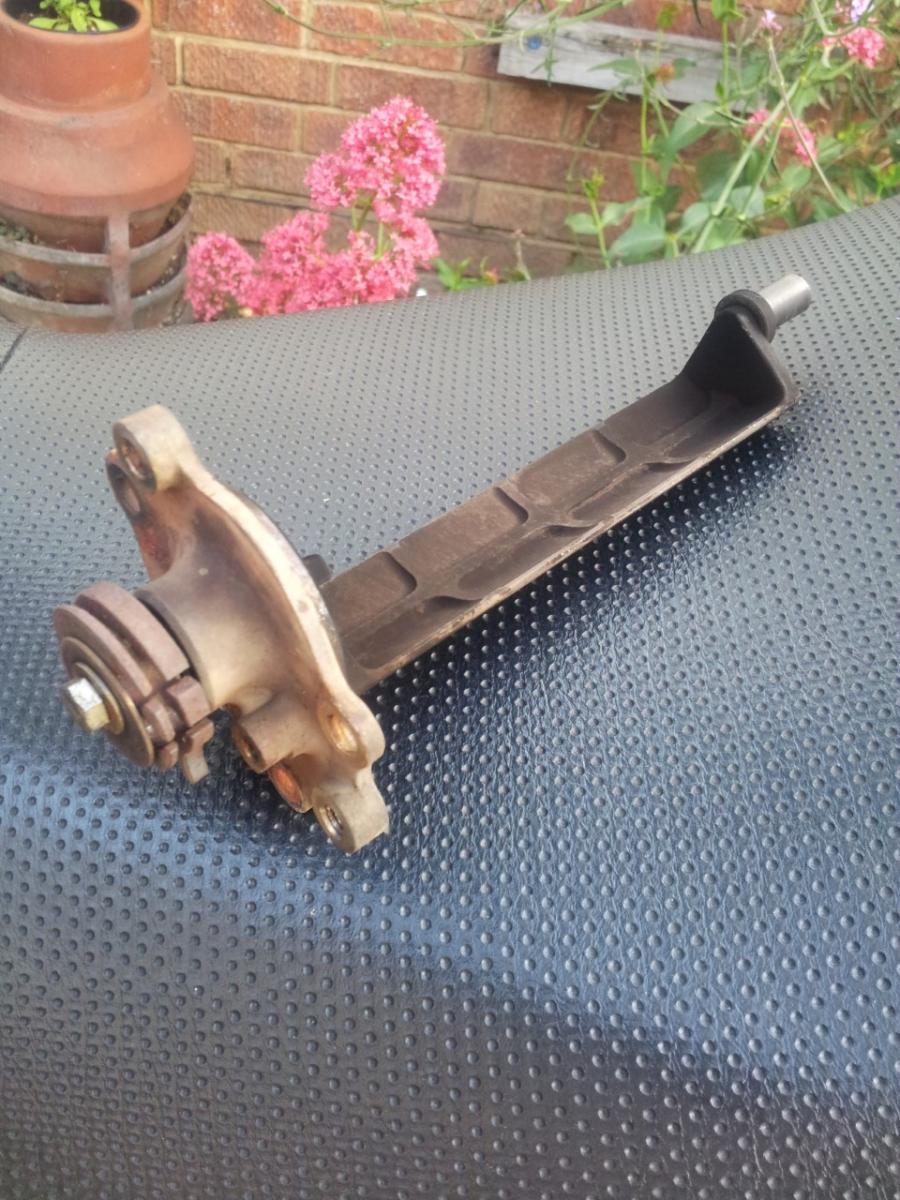

Re: A bit of advice needed for new owner. - final_edition - 02-06-17
Have soaked the valve spindle and body plate for hours.
Managed to push it through a few mm now it is not shifting. It is stuck fast.
Will have to get on the bearing press!!
Success!
A bit of persuation has it off.
Have cleaned the shaft and bush bore, now it rotates freely.
Will have to assemble it in the right order as it seemed to be wrongly put back together by whoever was in there before.
I have some hi temp wurth brake paste to use instead of copper grease.
