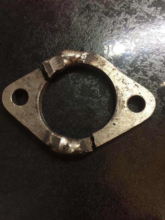

I bought a used set of s/s downpipes for my fzs600 and now noticied that the flanges have had welds put in previously and now have further cracks in them from being overtightened, unfortunately one has already snapped off.
Anyone know of any solution? can it be welded?
I've tried finding flanges in 2 parts that can be joined but no luck for the size and can't find a company to make any yet.

Looks like they've been welded but not ground flat afterwards. Personally I'd reweld but make sure there's a flat surface where it meets the rest of the system otherwise the flange is going to be stressed.

They're probably the Sandy Bikespares downpipes like I had. The clamps are made from a steel that has all the strength of peanut brittle. Weld them and they'll just snap elsewhere.
I ended up making my own from old Motad clamps.
Some bikes, Kawasaki GPZ900 and GPZ500s use overlapping "C"s, but are too large to suit the Fazer 600.

Yeah I saw the overlapping type and someone on here had made their own, which I hoped to do from the original ones but unfortunately the inner diameter of the originals is too large.
I have no idea about welding but I'm guessing from your response it will be ok to have them welded even though they have broken in half and have a few cracks

(02-05-17, 05:46 PM)Panthor link Wrote: Yeah I saw the overlapping type and someone on here had made their own, which I hoped to do from the original ones but unfortunately the inner diameter of the originals is too large.
I was puzzled about that for a moment... then remembered the OE pipes are double-skinned which would be why they're a larger diameter. :lol
