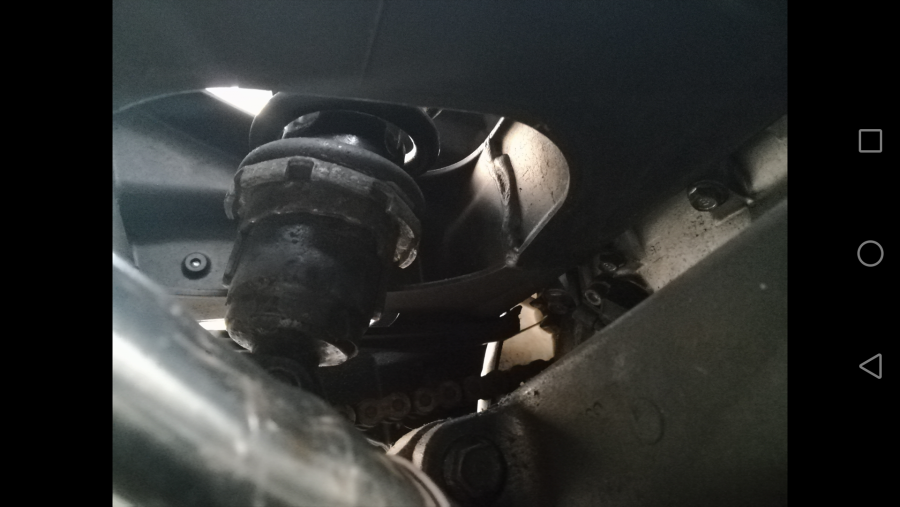

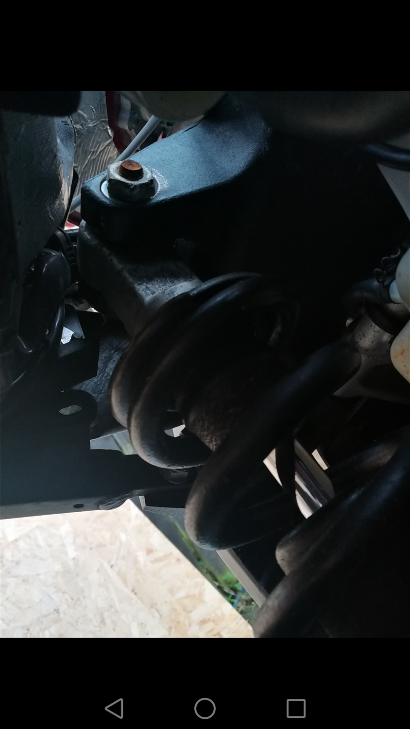

Is there any reason why my rear fz1 suspension would be fitted with the damping adjuster screw at the top and rebound cog at the bottom???
Just looked at the owners manual and its defiantly backwards.
Bought the bike from a main dealer with only 2000 miles and a good history.

Re: Suspension fitted the wrong waky up?! - clumptydumpty - 14-04-17
Pic1, pic2

Is it possible that the previous owner fitted or had it fitted upside down so as to make the preload adjuster easier to get to? Just a thought. Smile
Re: Suspension fitted the wrong way up?! - Hamos - 18-04-17
Yep, it is upside down.
Will probably make no difference to the working of the shock, but would think getting to the adjusters would be more difficult.
