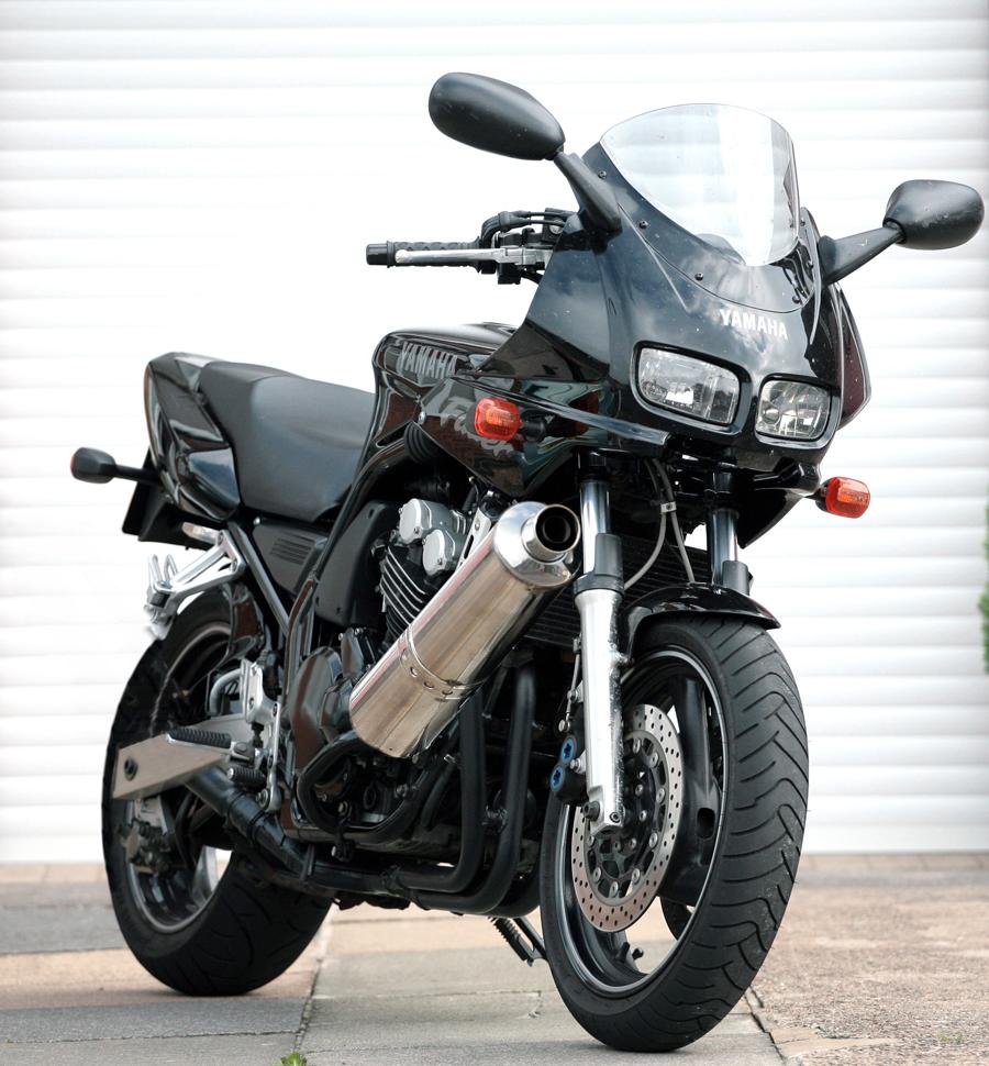

The excuse about car drivers hearing us is just a smoke screen and pointless. Unless you do what I have done here
Re: Louder exhaust can for FZS600 - vinnyb - 10-04-17
Hmmm.... I think it's lost something aesthetically, i.e. It looks foccin' awful :lol  and as you're hurtling along at full racing snake speed, the noise is still going out behind you Not to mention what it's doing to your back pressures, added to the 180° bend in the pipe you may end up with running issues.
