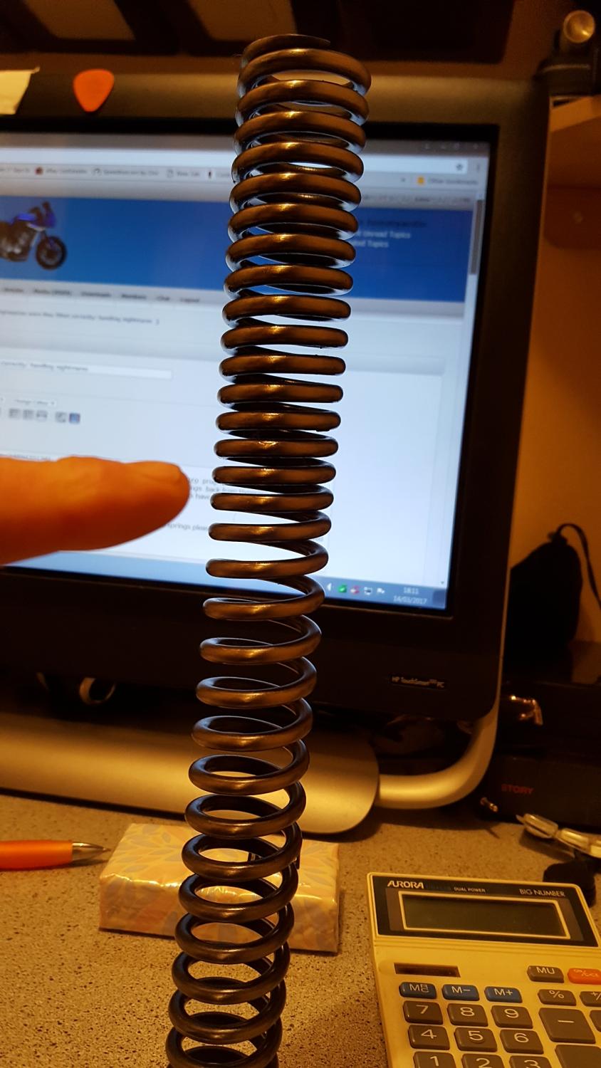

I was told that the FZS 600 came with Progressive springs as standard, but in fact they are not progressive they are 'Dual Rate' springs please see photo of the springs i removed from my FZS 600.
Progressive Spring as the name implies change rate slowly from one end to the other (Slow change in the pitch of the spring from one end to the other) = smooth increasing compression transition, stiffening throughout their length, should equal better handling.
Dual Rate Spring (See picture) again as the name implies two compression rates, after the initial softer rate is overcome the second harder or stiffer rate come into play causing changes in the motorcycles geometry (Especially when cranked over into a bend and hitting undulations in the road surface) = arse clamping up and nasty marks in your Y fronts.
See the piccy and the spring rate changes at the place my finger is pointing.
My understanding is that progressives are a vast improvement on the Standard Yamaha Springs, but it is a 'One Spring Suits All' situation
Ideally one spring can not suit a 9 stone rider and the same spring suit a 20 stone rider, it will always be a compromise.
With Linear the spring rate stays the same throughout the total length of the spring,
of course progression still comes into play but it does not change rate =  better stability, constant contact and feel and little or no diving in or running wide on a bend because of geometry changes because of bumps and lumps mid bend. You purchase the spring rate to suit your on board rider weight.
