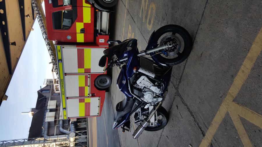

Re: Exup for sale?? - Dudeofrude - 11-03-17 Just as a curiosity have any other mods been done? I'm not 100% sure how it works with a gen1 but I'd assume the person that removed it did so for some kind of power increase so maybe they've modified a few other bits to make it work without? Or does it suffer from a loss of low down power? Re: Exup for sale?? - tex - 11-03-17 There's one on ebay original fazer , £32 plus £20 post from United States, worth a look item number 401287767923 Re: Exup for sale?? - drew70311 - 11-03-17 Great thanks I'll have a look. The cables are still there tie wrapped to the frame ?!?! And there is a noticeable flat spot below 3k that has been helped marginally by putting baffle in the Beowulf end can. I'd hope there'll be no flat spot if I was to replace the valve I'm going to get the tank off tonight and do some digging, to see I'd there are any other unknown modifications Re: Exup for sale?? - drew70311 - 11-03-17 I've had a look at the american valve, looks a good deal for someone, I'm missing everything though, I'd need the cover, cable guiders spacers etc etc as well so looking for headers with it still on Re: Exup for sale?? - drew70311 - 11-03-17 She's a looker though
