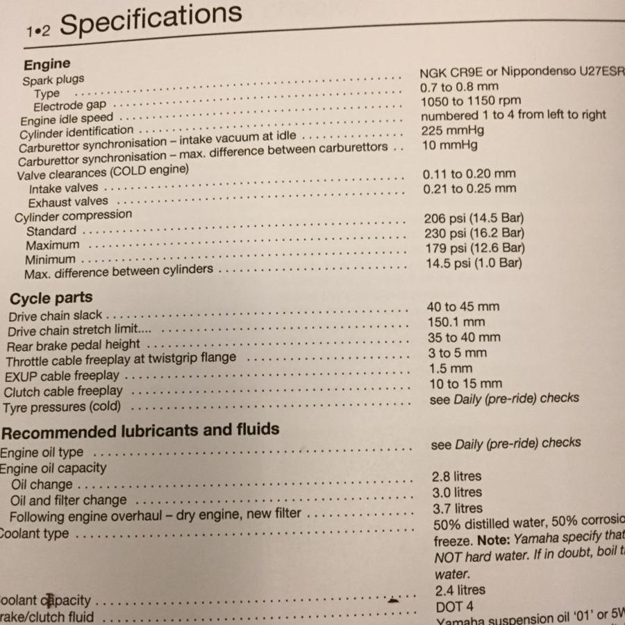

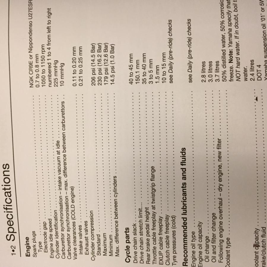

Re: Cylinder Compression... - tommyardin - 05-03-17
Dunno if this helps Haynes manual info.

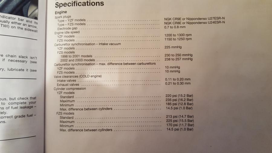

Re: Cylinder Compression... - Graham53 - 05-03-17
Tommy posted the compression figures from the 600 , these are the ones from the 1000
Dont know why it came out sideways , bloody camera phones

Re: Cylinder Compression... - tommyardin - 06-03-17
(05-03-17, 10:30 PM)Graham53 link Wrote: Tommy posted the compression figures from the 600 , these are the ones from the 1000
Doh!
