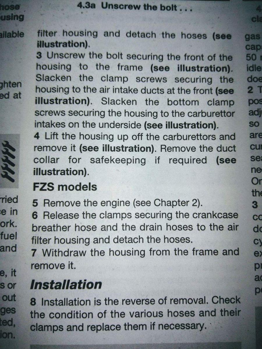

dont do any of my own work on bikes, but thought, sod it, I'll try.....
Did il and filter, plugs etc, went to do the air filter and thought WTF !!!!
Luckily, Tefer sent me a link from you tube.
Does anyone actually follow Haynes nformation ? Lol
Re: Never trust a Haynes manual - daviee - 04-03-17
thats to  remove the air box not the filter
Re: Never trust a Haynes manual - tommyardin - 04-03-17
10 minute job according to the information you posted from the Wonderfully Accurate Haynes Bible.
Man up Disky don't be such a lightweight  :lol :rollin :rollin
(04-03-17, 07:18 PM)tommyardin link Wrote: 10 minute job according to the information you posted from the Wonderfully Accurate Haynes Bible.
The other way is remove the fuel tank and do it from under there, but that is the way lightweights do it, you know those ones with no commitment and no appetite for adventure. :eek
I have a Haynes manual and must admit it's been useful, but if the is the way they recommend changing the air filter element I will question their judgement on future maintenance

Seriously it is an easy job to change the air filter, loosen the bolt/allen screw at the front of the fuel tank just behind steering yoke, remover seat, undo the bolt that passes through the brackets at the rear of the tank, get a suitable size piece of wood about 16 inches long by about 3 inches deep, raise the tank from the back and slide the piece of wood under the tank about 1/3rd the way along from the rear between the bottom of tank and the frame, the screw at the front that you loosened will keep the tank in place and stop it falling off the frame. Under the rear of the tank is a fuel tap, shut the tap off and disconnect the the fuel line by pinching the two lugs on the clip together with a pair of pointed nosed pliers, a small amount of fuel will come out of the pipe but nothing to worry about, you can slip a piece of rag under the fuel tap if you wish to catch the leakage. You will find a electrical green connector and plug that that connects to the fuel gauge disconnect this by just unplugging it. you can now remove the screw from the front of the tank completely and lift the tank from the bike. put it in a secure place where its not going fall or get damaged. Change the filter element and put bike back together in reverse procedure. Not forgetting to connect the fuel pipe and fuel gauge electrical connector, and don't forget to switch the fuel tap to the on position.
45 Minutes if you take your time and have a wipe around under the tank with a rag dampened with WD 40.

Re: Never trust a Haynes manual - Bretty - 05-03-17
ASSEMBLY -
Assembly is the reverse of disassembly.

Re: Never trust a Haynes manual - daviee - 05-03-17
if you look under maintenance procedures page 1.12 it shows you their how to remove the air filter the other is for removing the air box    simples

Re: Never trust a Haynes manual - Disky - 05-03-17
It's done, new oil & filter and plugs Smile so chuffed with myself lol
