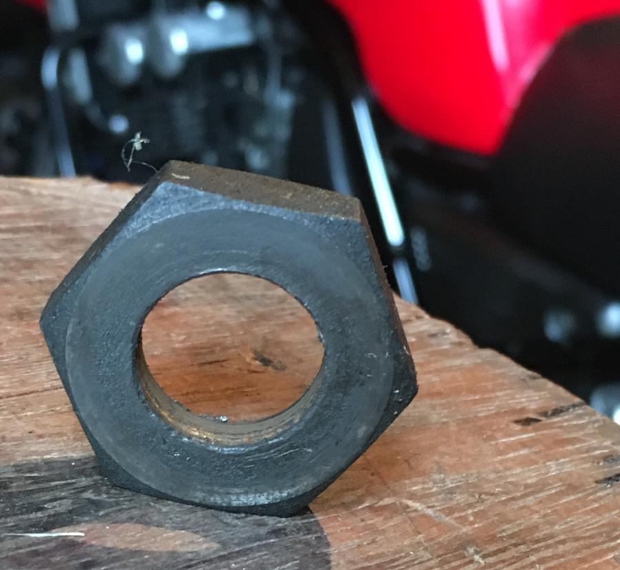

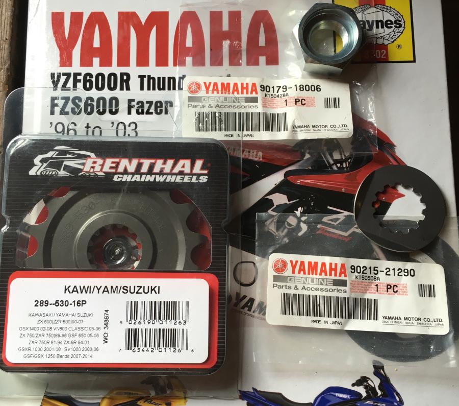

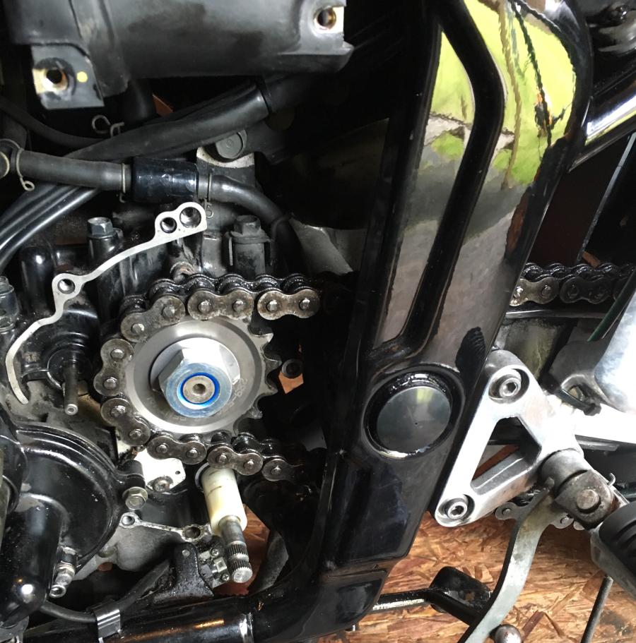

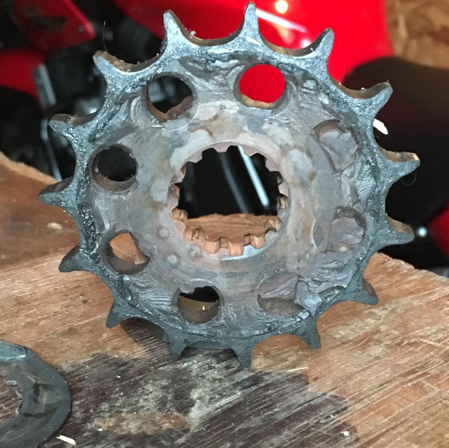

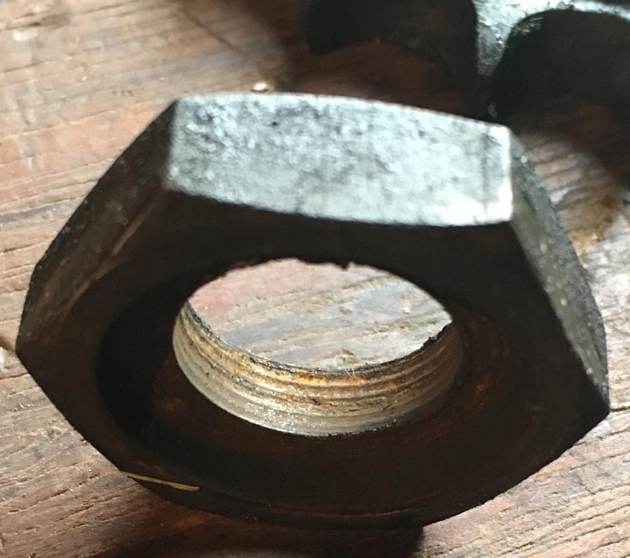

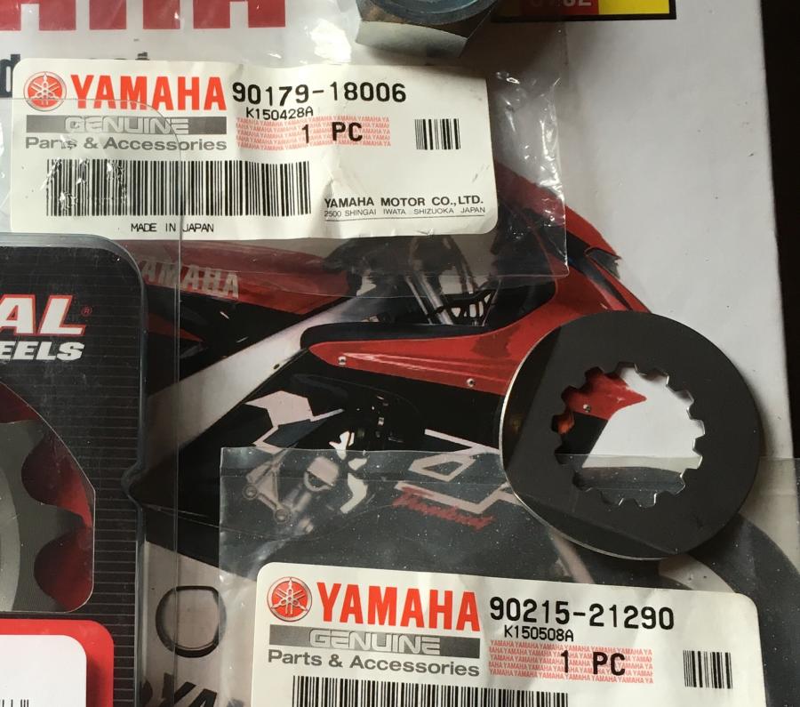

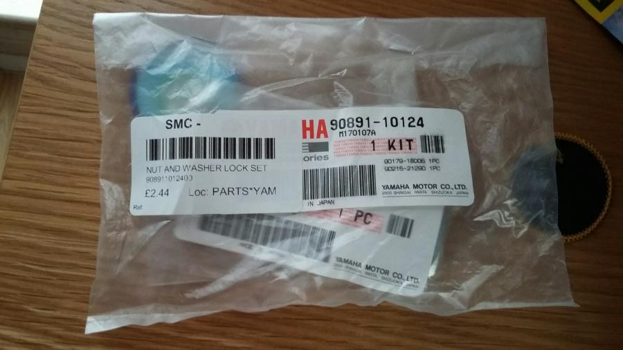

Lucky lucky lucky!! - SutherlandFZS600 - 04-03-17 I'm sure you folk are well aware about the well known sprocket nut issue? Well after buying the bike last year I was delighted with it even if I had only done 10-20 miles before tucking it away for the winter! As with everything I've owned/bought I always like to strip it down and check all the wear and tear items e.g., pads, calipers, seals, bearings, bushes and well everything really. So I'm a bit pernickity so had a list as long as my arm with things needing done which probably didn't but anyway this bloody did!!! Re: Lucky lucky lucky!! - SutherlandFZS600 - 04-03-17 An other pic Re: Lucky lucky lucky!! - SutherlandFZS600 - 04-03-17 And an other ha Re: Lucky lucky lucky!! - Tefer - 04-03-17 Yep good to get these checked. Hope you've got the upgraded nut on order. Re: Lucky lucky lucky!! - SutherlandFZS600 - 04-03-17 Yeah well bought the bike last found this when stripping down a few month back and then educated myself with the known issue! Luckily shaft and threads were perfect show new sprocket and nut fitted! Sprocket was needing done anyway Re: Lucky lucky lucky!! - SutherlandFZS600 - 04-03-17 Along with as you say genuine yam updated nut and washer Re: Lucky lucky lucky!! - Tefer - 04-03-17 Did you just do front sprocket, do you know what mileage the chain has done, i'd be tempted to do it all? Re: Lucky lucky lucky!! - SutherlandFZS600 - 05-03-17 Yeah the whole lot has been replaced since taking pics, was short on pennies at the time and after pay day she was spoilt then :lol Re: Lucky lucky lucky!! - HarryHornby - 05-03-17 Possible stupid question alert but just double checking, is buying this one from wemoto ok (correct part number) or should I be going to Yamaha to be charged a lot more money? http://www.wemoto.com/parts/picture/yh-90891-10124/ Re: Lucky lucky lucky!! - celticdog - 05-03-17 (05-03-17, 09:16 AM)HarryHornby link Wrote: Possible stupid question alert but just double checking, is buying this one from wemoto ok (correct part number) or should I be going to Yamaha to be charged a lot more money?No Harry. Go to yamaha, the sprocket nut upgrade is to cover their ass. As such it's offered to us foccers as a special kit at a knock down price. You do however need to provide the right code- see pic ![]() Re: Lucky lucky lucky!! - Tefer - 05-03-17 (05-03-17, 09:16 AM)HarryHornby link Wrote: Possible stupid question alert but just double checking, is buying this one from wemoto ok (correct part number) or should I be going to Yamaha to be charged a lot more money? I'd go to Yamaha, think its about £6 max. Re: Lucky lucky lucky!! - bandit - 05-03-17 Still cheaper at Wemoto delivered then, £5.47p. [img alt=Smile]http://foc-u.co.uk/Smileys/efocicon/smile.gif[/img] Re: Lucky lucky lucky!! - celticdog - 05-03-17 have a look at the picture, it's £2.44 Re: Lucky lucky lucky!! - SutherlandFZS600 - 07-03-17 This is the nut and washer I was supplied, I never went direct to yam can't for the life of me remember where now?! Re: Lucky lucky lucky!! - Disorderlypunk - 07-03-17 as i have only owned the fzs a month i have to ask what the front sprocket nut issue is looks like the threads disappearing / anything else i should know (one more little job to look at tommorow) Re: Lucky lucky lucky!! - darrsi - 07-03-17 (07-03-17, 01:15 AM)Disorderlypunk link Wrote: as i have only owned the fzs a month i have to ask You can start here, or just use the search part above and type in "front sprocket nut". http://foc-u.co.uk/index.php/topic,4546.msg45712.html#msg45712 Re: Lucky lucky lucky!! - fazersharp - 07-03-17 So then Mr SutherlandFZS600 Is your bike a 98 or a 99 also how many miles Did the front sprocket have an orange plastic bit on it Do you know if the sprocket has been changed in the past Re: Lucky lucky lucky!! - SutherlandFZS600 - 08-03-17 I believe mine to be a 98 fazersharp Front sprocket did not have any orange plastic bit on it I'm unsure if it has been changed or if that was the original sprocket. Why are you asking all this anyway? Re: Lucky lucky lucky!! - bandit - 08-03-17 The original front sprocket had a orange centre so it has been changed at some point in the past. [img alt=Smile]http://foc-u.co.uk/Smileys/efocicon/smile.gif[/img] Re: Lucky lucky lucky!! - fazersharp - 08-03-17 (08-03-17, 10:55 AM)SutherlandFZS600 link Wrote: I believe mine to be a 98 fazersharpIts because i have a theory that the 98 FZS does not suffer from the famous sprocket nut issue, but it has to be an factory fitted oem one to rule out any bad fitting by someone else. So when you post with a 98 saying your nut has come off I want to see if it is a factory fitted one that has failed, but no it looks like I can chalk up another 98 that is in the clear and another 98 proving my theory. Search here for Sprocket Nut and you will find my posts |
