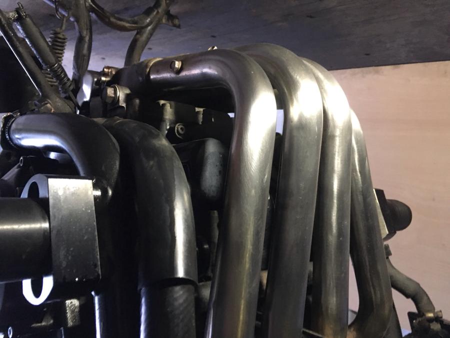

I commute Monday Tuesday Wednesday, but home early on Wednesday, so religiously wash/ fs365 the bike along with clean the chain/ relube and clean rear shock and tie rods etc with wd40 every Wednesday afternoon. Every three or four weeks tops I check tyre pressures and take all three calipers off, drop the pads out and clean Pistons anti squeal shims pins etc, coppa grease and back together, along with running all the exup stainless cap heads out and back in again with coppa slip. I also clean the headers up with one of them green pads the missus uses to do saucepans. I'm assuming they are stainless, mine get filthy with all the shit on the roads around here this time if the year( the commute is probably about 200 miles and it's nearly always wet, with salt and mud from tractors thrown in) do you think I should just stick to washing them? They get stains behind the crud that won't come off with soap and water. Breaks me heart to use the bike like this but needs must

Alloy wheel cleaner brings them up a treat, brush it on and leave it a few minutes then wash off. Follow up with some solvo auto sol for a sparking shine.
Oven cleaner Gel is also good
The green scotchbrite pads can be used to remove stubborn bits or road detritus.

What about a good coating of acf50 ?
I don't have the problem with the same level of mud and crud etc that you're describing but I've always done my bikes in that and although I've only had my thou for a short while my 600 is 14 years old and still on original headers, it smokes like hell at first but any road crud washes of pretty easily after, it's pretty good stuff  Smile

Cheers guys I've got some acf50 I'll give it a go. Took the zzr 11 out today, once the roads are dry it seems to lose 100kg, had a ball

(17-02-17, 10:50 AM)ogri48 link Wrote: I commute Monday Tuesday Wednesday, but home early on Wednesday, so religiously wash/ fs365 the bike along with clean the chain/ relube and clean rear shock and tie rods etc with wd40 every Wednesday afternoon. Every three or four weeks tops I check tyre pressures and take all three calipers off, drop the pads out and clean Pistons anti squeal shims pins etc, coppa grease and back together, along with running all the exup stainless cap heads out and back in again with coppa slip. I also clean the headers up with one of them green pads the missus uses to do saucepans. I'm assuming they are stainless, mine get filthy with all the shit on the roads around here this time if the year( the commute is probably about 200 miles and it's nearly always wet, with salt and mud from tractors thrown in) do you think I should just stick to washing them? They get stains behind the crud that won't come off with soap and water. Breaks me heart to use the bike like this but needs must
How did you attach the bike to the ceiling to clean the headers?  :lol
Re: Useing the bike through winter, stainless headers? - ogri48 - 21-02-17
Wasn't easy. Calls for diligence... Smile
