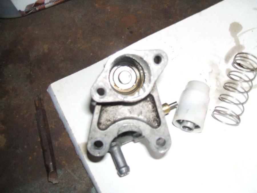

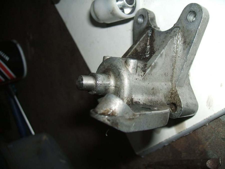

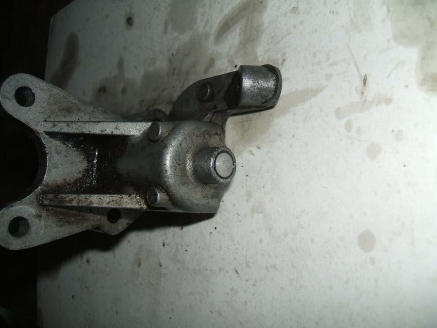

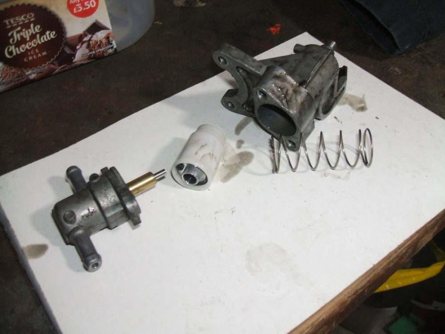

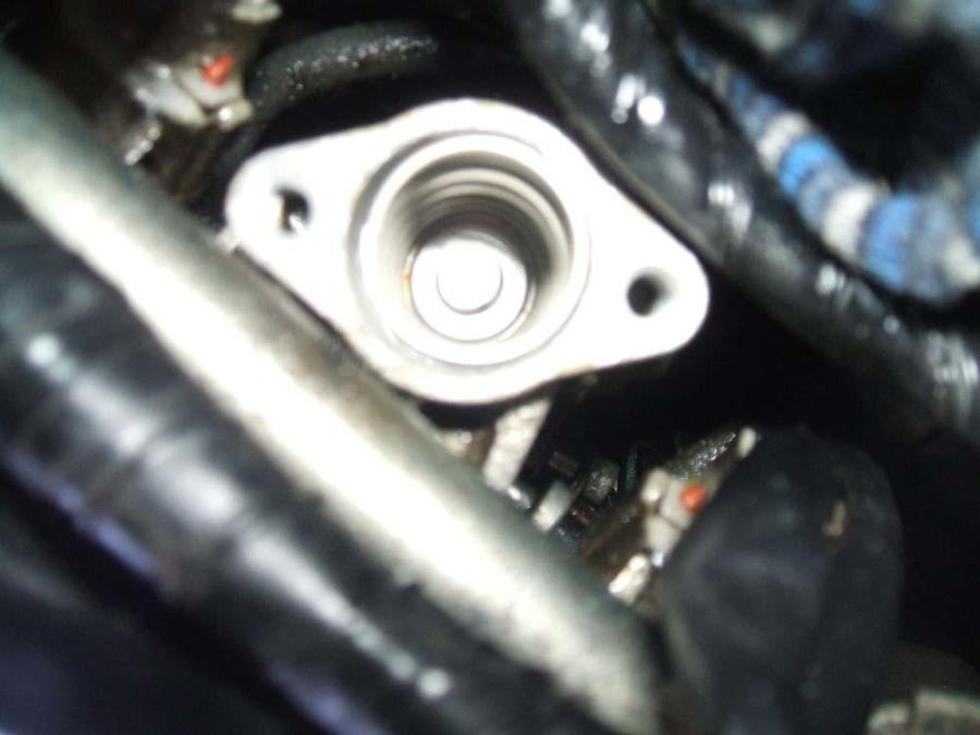

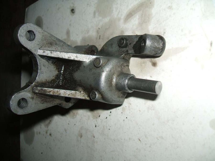

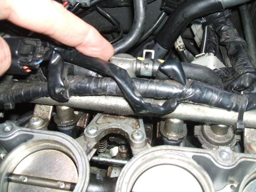

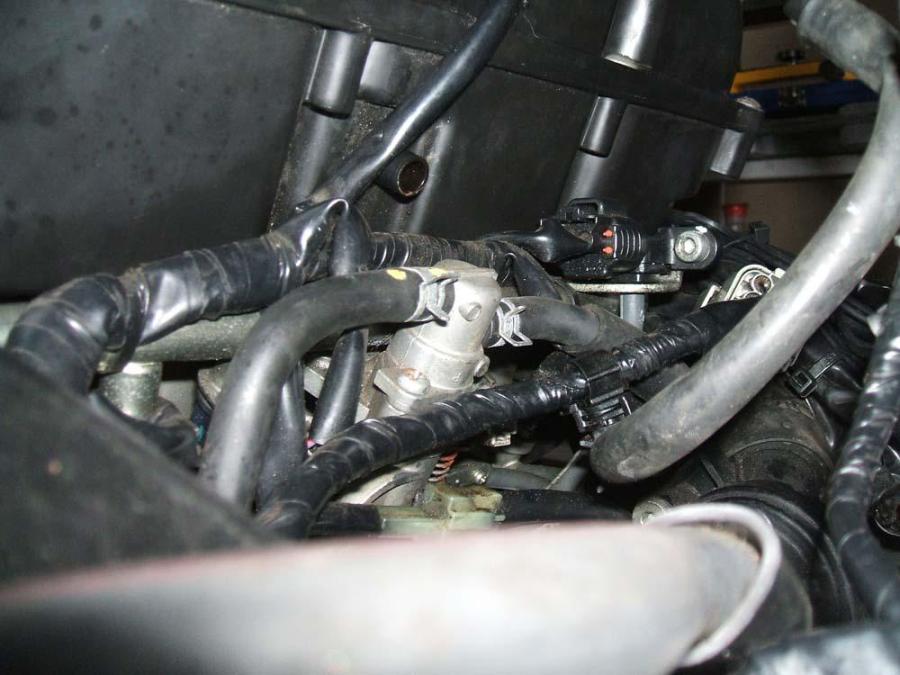

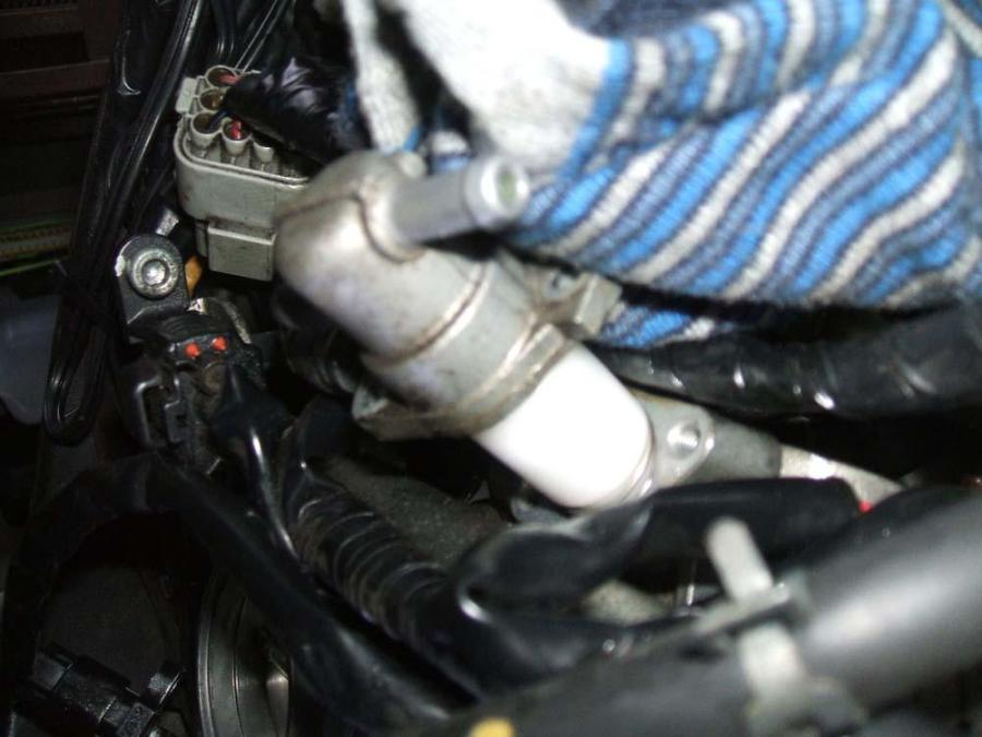

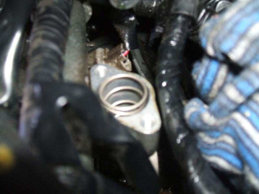

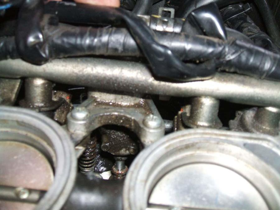

Firstly many thanks for all the advice on the forum, was reading recently about the thermowax unit and quickly realised that this was the reason for my idle problles from a cold start.  Stripped the thermowax unit today and now working perfectly.  The rod was solid in the out position needed a few hits from a pin hammer and 3-1 oil to free it up.  A couple of points (problems) that that I had.

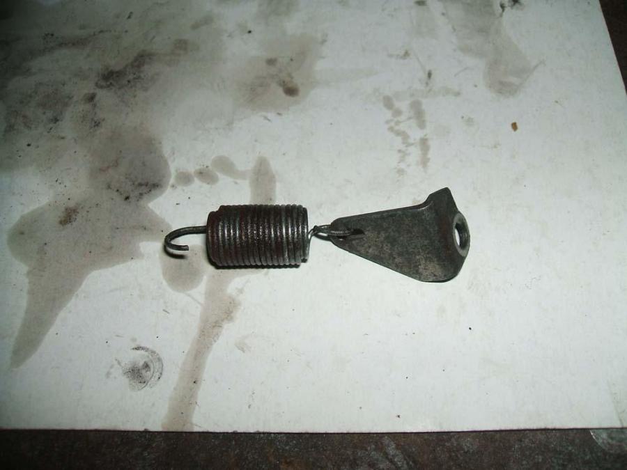

(1)  the righthand screw for the top of the Thermowax unit holds a very small metal bracket that the spring attaches to (the other end of the spring attaches to the throttle body) when I unscrewed the screw the bracket and spring pinged into the bowels of the engine - thank god for telescopic magnets!  (see photo 12 for bracket and spring) :o
(2) the two screws holding the thermowax unit to the bike were solid.  I tapped them free with a cold chisel and pin hammer and replaced the screws.
I took a few photos for reference which I thought may help out anyone else that does this job.

The last photos - the final one show the small bracket and the sping with attached to the righthand side screw
Re: Thermowax Unit - Idle Problems - Reference Photos - tommyardin - 28-01-17
Never mind the thermowax thingy its the Triple [size=1.45em]Chocolate Ice Cream[/size] in picture 7 that holds my interest
Re: Thermowax Unit - Idle Problems - Reference Photos - Ash69 - 28-01-17
Yeah that's the monkey Bruce, glad you found the spring tab , I ended up improvising with a couple of tiewraps until I can manufacture something more representative - or the original dislodges itself from the deep .... bodge seems to be working okay though :-)
Re: Thermowax Unit - Idle Problems - Reference Photos - Bruce - 28-01-17
Yes glad I found the spring.  Got some 'Ben & Jerry's tonight lol!
Re: Thermowax Unit - Idle Problems - Reference Photos - Bruce - 29-01-17
Ash69 - I managed to get my tab by poking a telescopic magnet down below where it came off and the magnet eventually latched onto it.  May be worth a go if you have not already tried?
