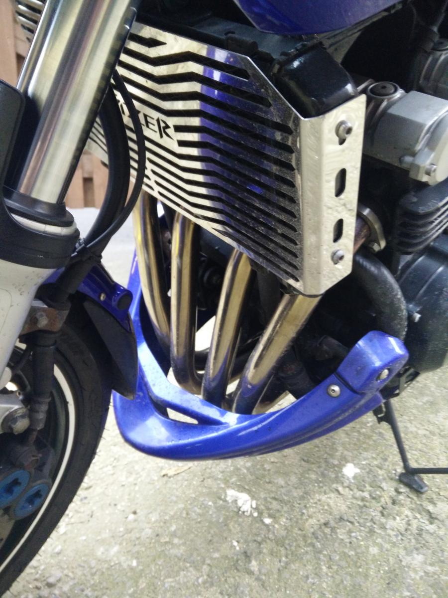

Hey foccers, need a little advice, started the bike and its running lumpy as shit (sounds like its only running on 3 cylinders) once warmed up it runs OK and sounds OK. However only 3 of the four header pipes seem to be getting hot. The one on the right in the picture doesn't get anywhere near as hot. Would a new set of plugs sort this?

Well just been out for a 30 min ride, and same still happening, noticeable a lot more when bike first starts however bike still seemed hesitant throughout the ride. When I got home I quickly felt the headers and the first was although warm was nowhere near as hit as the rest. I'm gonna have to bite the bullet I think and get it to the garage for new plugs and a carb balance as the last bloke I bought it off had clearly left the poor thing sat there for months on end without rising it.

All these possible solutins Sad I have read a lot of other posts on here as well suggesting it might be a blocked jet. In higher revs, I.e above 5000rpm it seems a lot less noticeable. When the bike is cold and at lower revs its like a tractor. The first header pipe gets warm but not unbearably hot to touch so does that indicate a knackered plug or could it be a carb issues for that cylinder? I don't want to get ripped off at the garage either. And here's me thinking I was in for some trouble free biking, had nothing but issued with the foccer and haven't even started using it for commuting yet

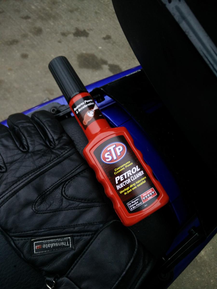

Re: running lumpy - darrenc - 22-01-17
Despite their online catalog saying there was one in stock there was Nome left so settled for this (see attached pic) stuck full lot and and blasted the foccer down the motorway (within legal limits of course officer) after one hour of tootling about its made no difference, jumped of the bike and touched the dirty foccers pipe number 1 and  still not red hot likenits 3 sisters next to her. I'm really hoping just a fucked plug or dirty corresponding carb is the issue, I can live with that. Also whilst the urbano tucano muffs kept my hands toasty as fuck I just can't get on with them so if anyone wants a pair they can have them for £25, they cost me £45 Inc postage just 2 days ago.
