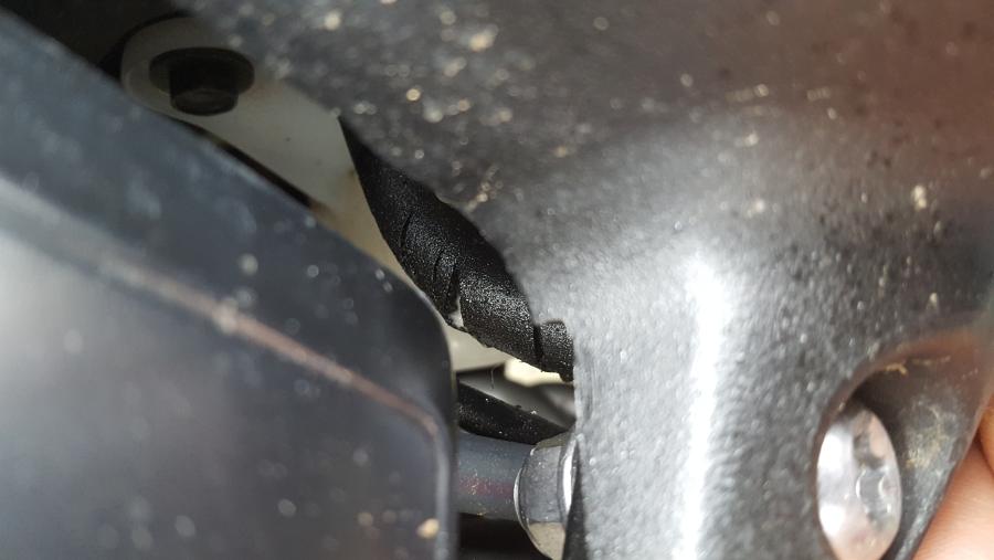

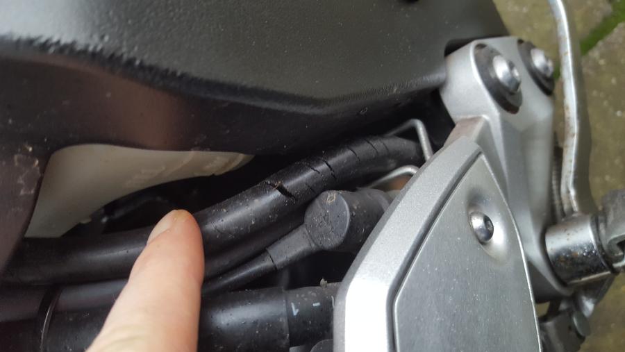

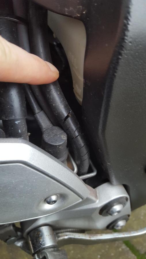

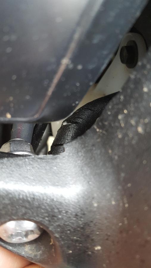

Severely split pipe - Dudeofrude - 21-01-17 As some of you may know I have been having trouble with a burning smell on my bike. I was getting quite worried as I was thinking something was burning up BUT after another soggy ride this morning I was wiping her down and found staines on my link pipe. After closer inspection I've found a more or less completely shredded pipe. I'm assuming it's some kind of breather pipe as it runs down behind the brake pedal and doesn't have an end on it? As you can see by the pics I've got it is an absolute mess? Looks like wolverines been at it haha The troubling thing now is A. Why is it spewing so much stuff out? Seems to be like white lardy looking stuff And B. How hard is it going to be to replace ?? Re: Severely split pipe - Bretty - 21-01-17 I don't know the FZ1 but on the 600 there are a few open ended pipes. (from memory) the petrol tank overflow pipe (either attached to tank, or a funnel arrangement on a bracket under the tank) and a coolant overflow pipe which comes out of the reservoir under the seat. Re: Severely split pipe - Fazerider - 21-01-17 If it's dribbling mayonnaise that sounds it's like a drain from the air box. The crankcase breather can blow emulsified oil and condensation into the box, at this time of year the cause is probably just oil temperatures not getting high enough to evaporate the moisture but it is always worth checking coolant level to make sure. Re: Severely split pipe - slappy - 21-01-17 (21-01-17, 02:23 PM)Fazerider link Wrote: If it's dribbling mayonnaise that sounds it's like a drain from the air box. The crankcase breather can blow emulsified oil and condensation into the box, at this time of year the cause is probably just oil temperatures not getting high enough to evaporate the moisture but it is always worth checking coolant level to make sure. :agree To replace it you will have to lift tank and airbox, detach old pipe from airbox and then if you can attach the new pipe to the old pipe and pull it gently down through the engine and frame you should be able to follow the correct routing. Usually it is to one side so the drips from it are not directly in front of the back tyre. Strange how it has cracked and deteriated so much on a bike that age. Maybe it was too close to exhaust and the heat has focced it. Many years ago I had a Bandit 1200 and the breather pipe from the airbox had a little bung in the end, every time I washed it I would remove the bung and get about an eggcup of fluid from it, a mate with same bike had never done it and I did his and nearly filled a jamjar, inside his airbox at bottom was wet through. Re: Severely split pipe - Dudeofrude - 21-01-17 OK thanks guys at least it's nothing major. I was worried it might have been the fuel one haha I'll wipe the tank off on Monday and see what's what then see about ordering a new pipe. I'm sure Mr Yamaha will have my pants down for wanting it then and there haha Re: Severely split pipe - darrsi - 21-01-17 You need to have a look under your air filter, the housing could need mopping up of emulsified oil. Re: Severely split pipe - Dudeofrude - 21-01-17 Just checked the manual and apparently that one is the fuel tank breather pipe?? But it's definitely got the emulsified crap coming out of it? Re: Severely split pipe - darrsi - 21-01-17 You wouldn't get that stuff coming out of the fuel tank breather, it would only be fuel. Airbox gunk looks like liquid honeycomb. Why the pipe is shredded is a bit of a mystery though. Re: Severely split pipe - Dudeofrude - 21-01-17 (21-01-17, 04:19 PM)darrsi link Wrote: You wouldn't get that stuff coming out of the fuel tank breather, it would only be fuel. Airbox gunk looks like liquid honeycomb. Yeah that's what I thought? And foc knows? I'll have to investigate a bit when I take it out. It might be catching somewhere? They are very neat splits, almost like it's getting cut on something ?? Re: Severely split pipe - tommyardin - 21-01-17 I wouldn't mind betting that a reasonably sized motor factors could supply piping that size in a clear plastic/nylon type material for a fraction of the price of the Yamaha replacement pipe and the plus side is you can see what is actually in the pipe being clear/see through. Re: Severely split pipe - Dudeofrude - 21-01-17 (21-01-17, 07:08 PM)tommyardin link Wrote: I wouldn't mind betting that a reasonably sized motor factors could supply piping that size in a clear plastic/nylon type material for a fraction of the price of the Yamaha replacement pipe and the plus side is you can see what is actually in the pipe being clear/see through. I was thinking along them lines Tommy. To be honest I don't even know what I have to buy but was gonna see if anyone could recommend something just to compare against the Yamaha original parts price. My only worry with something cheap would be the same thing happening again? Re: Severely split pipe - Dudeofrude - 22-01-17 Would this be alright to replace it with? I know it might be overkill but it would look nice and wouldn't ever split again? Re: Severely split pipe - slappy - 22-01-17 Perfectly ok to me, just check the spigot on the airbox where it fits is 8mm as well. Re: Severely split pipe - Dudeofrude - 22-01-17 (22-01-17, 08:53 PM)slappy link Wrote: Perfectly ok to me, just check the spigot on the airbox where it fits is 8mm as well.Cheers ?? Re: Severely split pipe - Rob R - 22-01-17 If it is the fuel tank breather pipe it should have a white band round it that lines up with the bracket. If not someone's maybe swapped the airbox breather and the tank breather?? AFAIK the airbox breather exits by the gearbox sprocket cover. If you use s/s braided hose you might want to protect anything it might rub against. Rob Re: Severely split pipe - Dudeofrude - 22-01-17 Well after Robs comment I had a look at photos of other Gen 2s and none of them have that pipe there so now I'm really confused? All of them only have the fuel tank breather and overflow pipes there? I'll hopefully get time to take it apart tomorrow an see what's going on but seems a bit odd that someone would reroute a hose? Re: Severely split pipe - crickleymal - 23-01-17 (21-01-17, 07:08 PM)tommyardin link Wrote: I wouldn't mind betting that a reasonably sized motor factors could supply piping that size in a clear plastic/nylon type material for a fraction of the price of the Yamaha replacement pipe and the plus side is you can see what is actually in the pipe being clear/see through.Probably get it from B&Q or if not Ebay will certainly have clear piping. Re: Severely split pipe - Dudeofrude - 23-01-17 Well I've just popped into the mechys so he could take a look and it's definitely the fuel overflow pipe so least it's nothing major to worry about. Don't know what the congealed crap was but his beat guess was something that's flicked up from the rear tyre Re: Severely split pipe - slappy - 23-01-17 If it is the fuel overflow pipe and the white stuff had been flicked up by rear tyre the stuff would have been on the outside of the tyre and not on the inside as can be seen in your first picture. I would still replace it, if it is that condition where you can see it what is it like where it is out of sight, last thing you need is petrol pising out over a hot engine underneatn your arse. Re: Severely split pipe - Dudeofrude - 23-01-17 Yeah I'm still replacing it ? |
