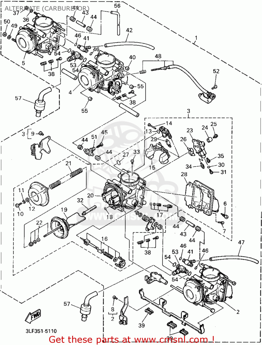

Re: Not starting crazy symptoms - unfazed - 10-01-17
Fzs1000 float bowl drain screws
