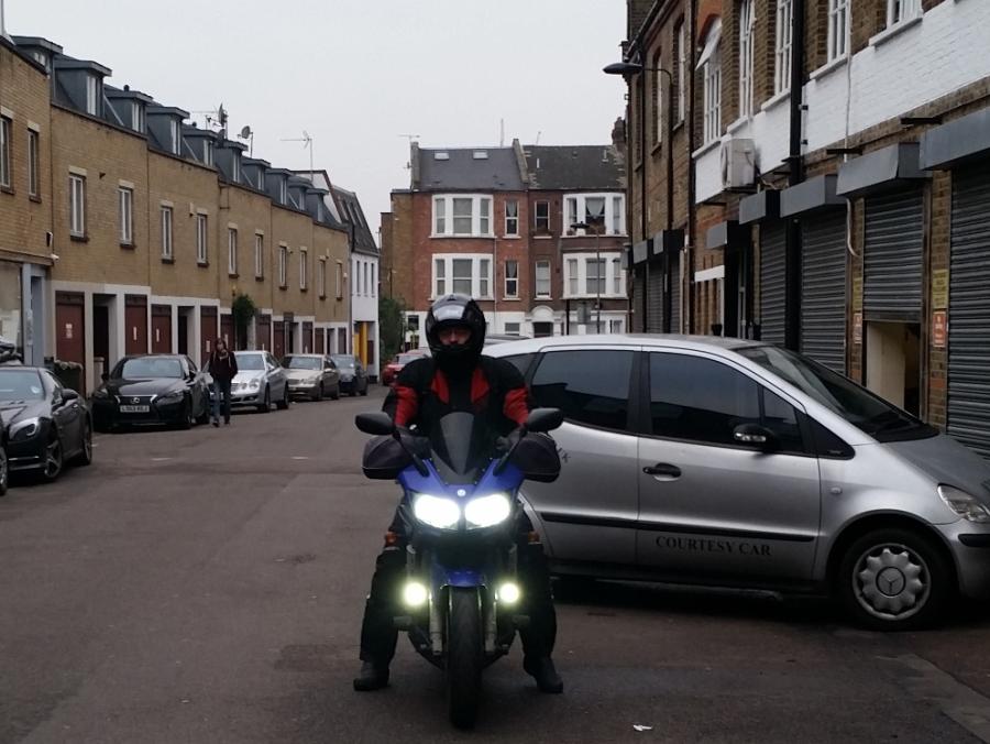

Right so tested it on the way home from work and I am 'mostly' impressed -
  • If we set the amount of light on the (super 120% brighter halogens! blah blah) as 50-75%, the LED bulbs would be 100% and a HID kit would be 120% and above.
  • The beam pattern isn't as full and contiguous as a HID would be, there were some small but noticeable 'dimmer' area's in said pattern.
  • These bulbs don't appear to be for the UK market to the kick-up that should be on the left is on the right - but I sorta got around that because the bulbs have the ability to be rotated in the holder (see the image in the OP that shows the little graduated lines, the bulb rotates in the base and has 2 little grub to lock it.
Here are the money shots -

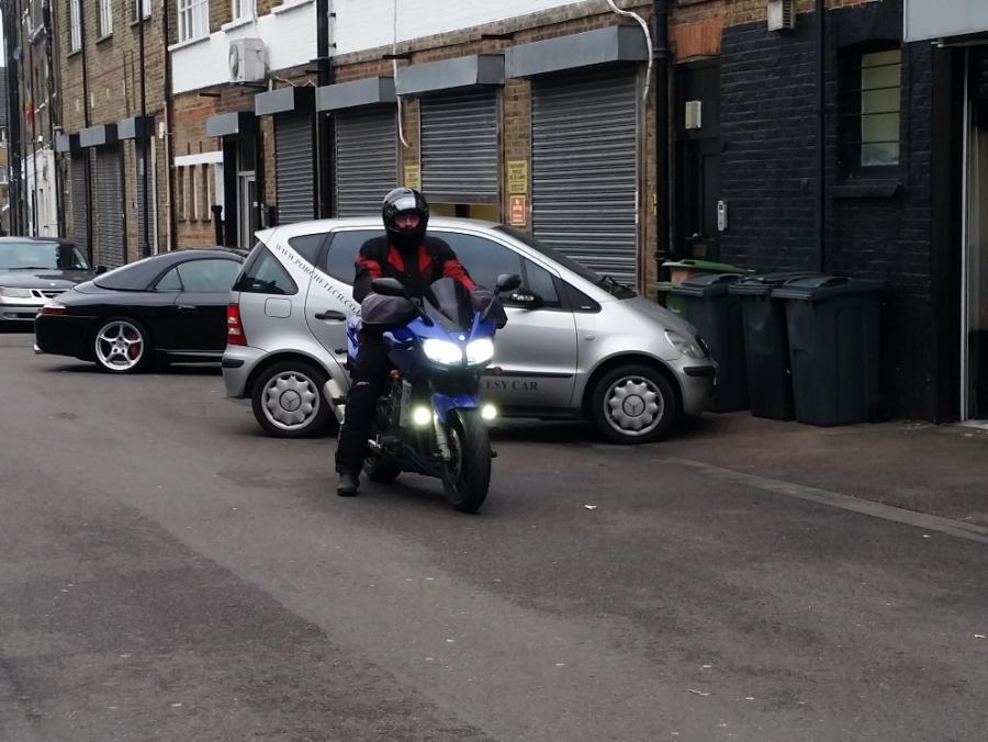

Re: What car drivers see - b1k3rdude - 15-12-16
Got a mate to take a shot of me on the bike, the new bulbs have less over-spill that the LED spots..
