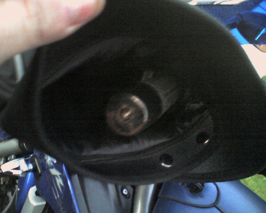

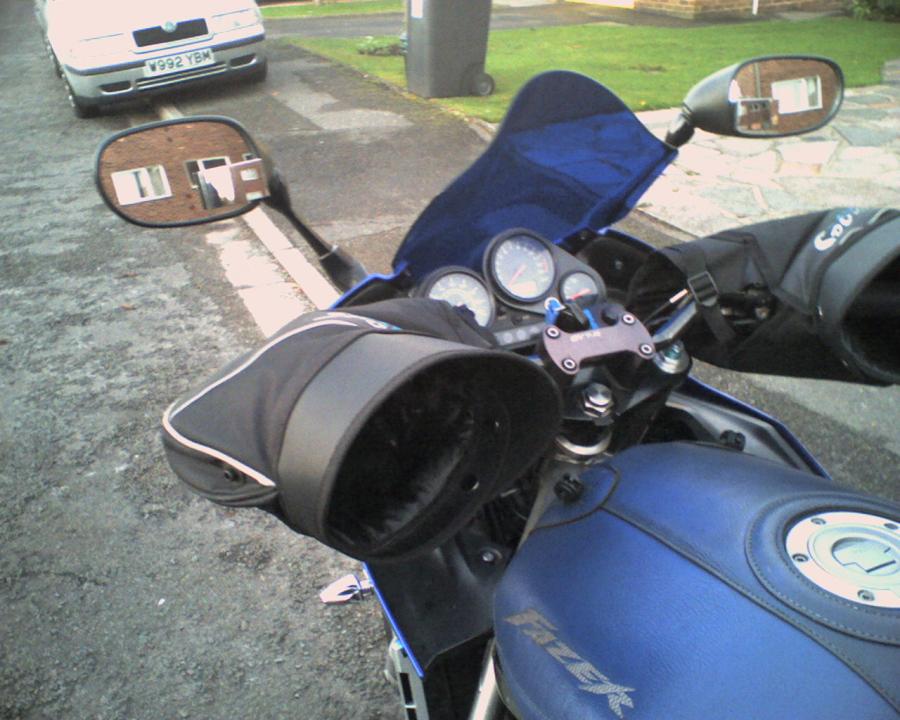

You only need two things to see you through the winter, I had these on the fazer then moved them to the bandit -
  • Dr Bike heated grips - these are based on the old but good analogue Oxford design - £39
  • Tech7 Handlebar muffs - These are semi ridged, and have 2" height that allow for better lever free-space- £17
The only mod-work you have to (and I recommend) you do is to drill and tap a small hole in the end of your bar ends so you can place a bolt through the muffs to keep them in-place. See attached images. And lastly use cable ties on the opposite ends to properly lock them down.

Re: Heated grips - b1k3rdude - 16-10-16
(09-10-16, 07:42 PM)Fazerjon link Wrote: Oxford Heated grips every time
The Dr Grips are based on the Oxford gen1 design, thre was nothing wrong with this but Oxford keep comoing up with new way to raise the price
(10-10-16, 07:05 AM)old son link Wrote: Can you wear gloves with the Tech7 muffs?
Yes, thats one of the reason these muffs are so good. The 1.5-2" height space makes it mucher easier to move your hand around, as well as making moving from the levers to the bar unhindered. However I dont use full winter gloves, I have a pair of Richa all ice polar toruing gloves. Not as thick as full winter so allow for more freedom of movement under the muffs, and due to being textile dry out far, far quicker then leather.
