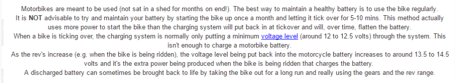

Re: Electrical question - darrsi - 16-09-16
