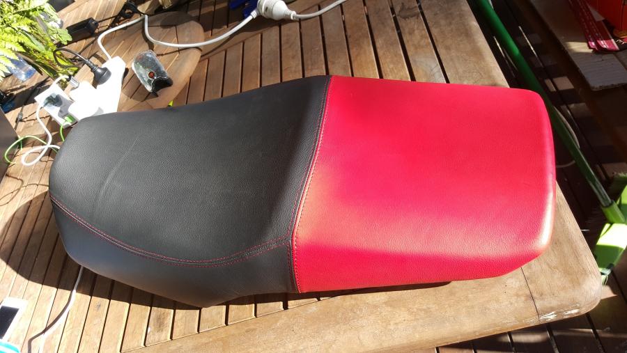

Has anyone done much with fixing seat foams?
My seat has been fine but a few months ago the vinyl cracked (yay sun) and it tore the seat foam a bit.
So i put duct tape over it and then put a nice looking cover over the top of it all but now the split has gotten worse underneath the new cover and the tape and the cover is now showing the crack through (and you can feel it when riding).
So basically my idea is to take the new cover off, take the vinyl off and then somehow fix the foam and just put the new cover on.
Two problems come to mind.
Is the vinyl cover glued to the OEM foam? Cos that'll make my plan a pain.
Is the foam closed cell or will it take up water like a bastard when it gets wet (cos i suspect my new cover is not waterproof).  Not keen on having a soggy seat for a week after it rains haha.
Alternatively i could somehow repair the vinyl cover somehow and then put my new cover over the top.
And a pic of my new cover just cos.
[Image: index.php?action=dlattach;topic=15720.0;...5700;image]

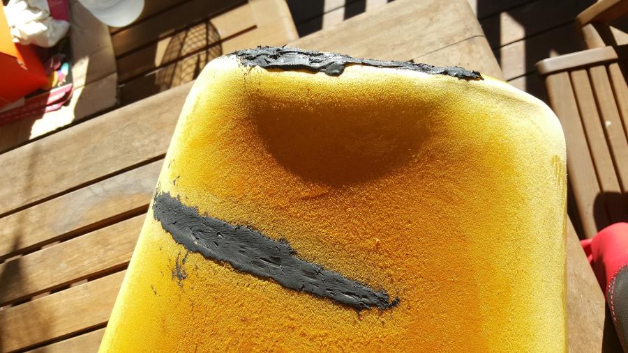

Re: Fixing Seat Foam - Nebuchernezzer - 28-08-16
Yeah i thought of seam sealer tape but i ended up being lazy and not getting any haha.
So i took the original vinyl off, fixed the foam up with silicon RTV and shaped it with a razor after it was dry.
Scotch gaurded the seat foam and refitted the cover.
Feels nice and comfy now without the hard vinyl under it and apart from a bit of a mark on the outer cover from when i was riding it with the gash in the foam so pretty happy.
We'll see how it goes in the wet.
