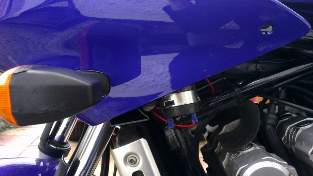

Re: Side mounted Dual Air horn? - Arfa - 21-07-16
Fitted my Stebal Nautilus under the infil just fine. Bit of a write up on my blog here: http://www.beginnerbiker.com/2014/09/honk-honk-stebel-nautilus-air-horn-installation-review/
[Image: StebelNautilus-Fitted2-1024x577.jpg]
I made a bit of a bracket, by bending some metal and drilling a couple of holes in it. Wired it with a relay (which I bolted to frame under tank just behind the yoke. All works a treat, definitely recommended.
