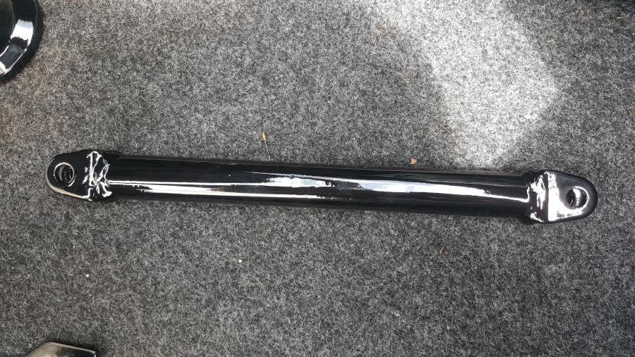

I have a repainted rear torque arm plus new stainless nuts and bolts ready to go if you are interested in buying
