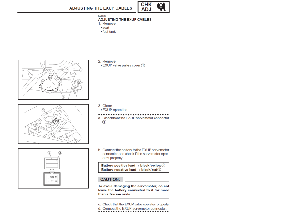

Exup Servo not working, sorry but can someone help please? - harrness - 09-06-16 Guys, I have sold my GEN1 and bought a nice Red 2006 GEN2, it came with a noisy Remus can. I have bought a standard can for MOT, fitted no bother, connected cables but the servo is no operating. Exup valve is nice and free, cables and free. anyone know how to test the servo? many thanks harry Re: Exup Servo not working, sorry but can someone help please? - DekF - 09-06-16 No need to stress. Nor is there any need to connect the cables from the servo to the exup valve. The reason being the exup valve in default mode is in the open position. It'll pass the MOT because the exhaust is oem & BS approved & not because the valve is operating or not. Re: Exup Servo not working, sorry but can someone help please? - harrness - 09-06-16 great news. thank you my good man. just out of curiosity. is there a way to test if the servo is working with 12v power supply? (09-06-16, 09:07 PM)DekF link Wrote: No need to stress. Re: Exup Servo not working, sorry but can someone help please? - Makiaveliko - 10-08-16 Hope that can help you. (Sorry this is for GEN1 i've lost myself reading :S) Re: Exup Servo not working, sorry but can someone help please? - Grayo - 10-08-16 Is the plug definitely plugged into the back of the Servo ? It may have had a Servo Eliminator fitted. Servo Eliminator would be plugged into the original plug on the end of the loom and looks like this. http://www.gravesport.com/Graves-Motorsports-Yamaha-Exup-Servo-Eliminator.html |
