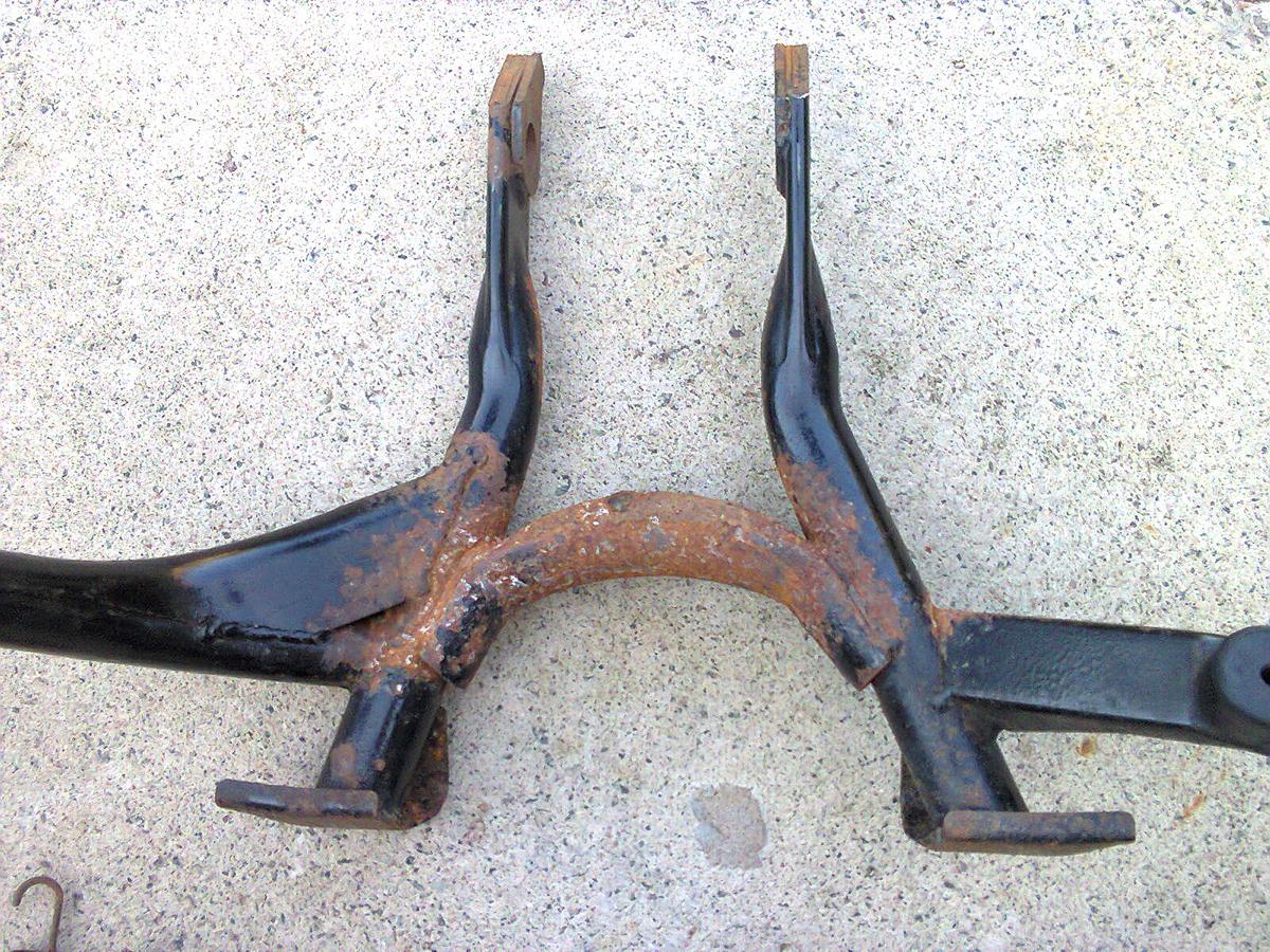

Well as per my last few posts I need to repaint my centre stand which I have started today, I have been putting it off as I would rather be riding it but so not wanting to give myself extra work I have also not been plastering it with ACF50, so I have been promising myself that the next thing I do before I ride again would be to re paint it.
Here are some pics with it in place and the last one with it off.
It isnt that bad but needs doing before it gets worse

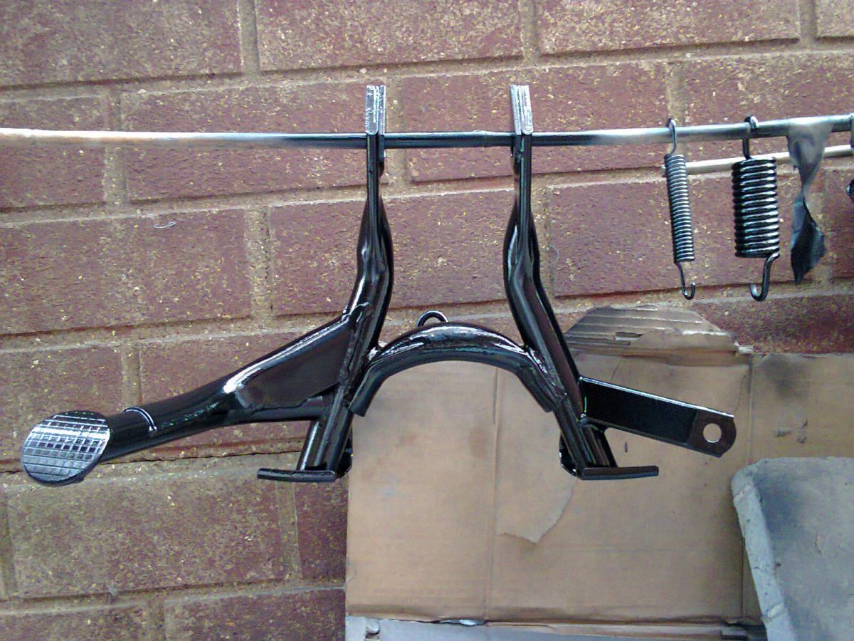

Re: My Centrestand Refurb - fazersharp - 09-05-16
A good de-rust and an undercoat and then a top coat on the stand today, There was an "incident" however with the rubber stopper, I read here just the other day about people loosing them so I though that it would be best to not move it and risk damaging it, I caught it with the bench grinder wire brush and sent it flinging up the garden  :rollin . It had ripped it off (see picture) so now I will have to re attach with a bolt :'(
The bit of tape on the right is where I hung my nuts ------ and bolts after first taping over the shaft part that will eventually be metal to metal with grease lube
Re: My Centrestand Refurb - sinto607276 - 10-05-16
Looking good, sure makes a difference once it's all shiney :thumbup
just watch though when you first use it to lift the bike, putting your foot on a newly painted bit of metal can just slip off Sad
Guess you'll be doing the side stand too once this is back on the bike, might be best doing that in situ as the side stand spring is a foccer to get back on Sad

Re: My Centrestand Refurb - fazersharp - 10-05-16
(10-05-16, 01:06 PM)sinto link Wrote: Looking good, sure makes a difference once it's all shiney :thumbup
Got tip with the foot.
I have already done the side stand by removing it and -- oh yes I know all about the spring, luckily in my tool box I have a big bag of swear words which were perfect to help get it all back on, I couldnt of done it without them.
