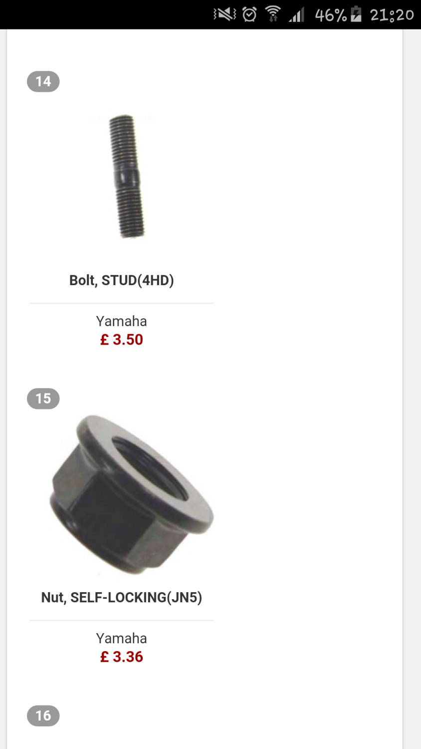

Just wondering if anyone's had a problem replacing the rear sprocket nuts/bolts?
I've just recently put on new chain and sprocket set but on looking at them again today I'm thinking I might of sheared 1 of them Sad
How easy are they to replace or do I need to get a whole new carrier?
Cheers.
Re: Rear sprocket nuts/bolts - unfazed - 02-05-16
They are studs which screw into the hub. I have found normally the threads in the nut strip before the stud shears.
Re: Rear sprocket nuts/bolts - sinto607276 - 02-05-16
(02-05-16, 09:06 PM)unfazed link Wrote: They are studs which screw into the hub. I have found normally the threads in the nut strip before the stud shears.
Cool so just some new nuts 'oh err missus' are needed?
Standard nuts or best going to ajsutton etc?
£41.16 to get a full set from Sutton or £20.16 to just get the nuts, either way cheap enough for peace of mind I think Smile
