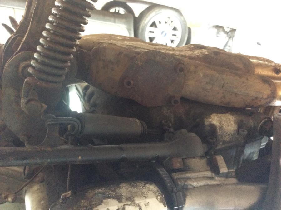

Sorry for the lack of photos and thanks for the replies so far. I'll work in trying to get some pics uploaded. I have done a bit more reading up and also had a good look at what is on the bike.
So.... There is a flat, solid plate bolted over where you would normally expect to see the exup cover.  The exup cables have not been removed from the bike. The ends of the exup cables that have been cable tied together and are hanging redundantly the above the plate.

Re: Newbie help with exup please?! - Tommy250_2 - 07-03-16
Here you are unfazed! A pic of the plate, ex up cables (I think)  in top right hand corner of pic.
Re: Newbie help with exup please?! - slappy - 07-03-16
I think I have sorted your problem, little known fact is the exup only works when the bike is the right way up Smile
