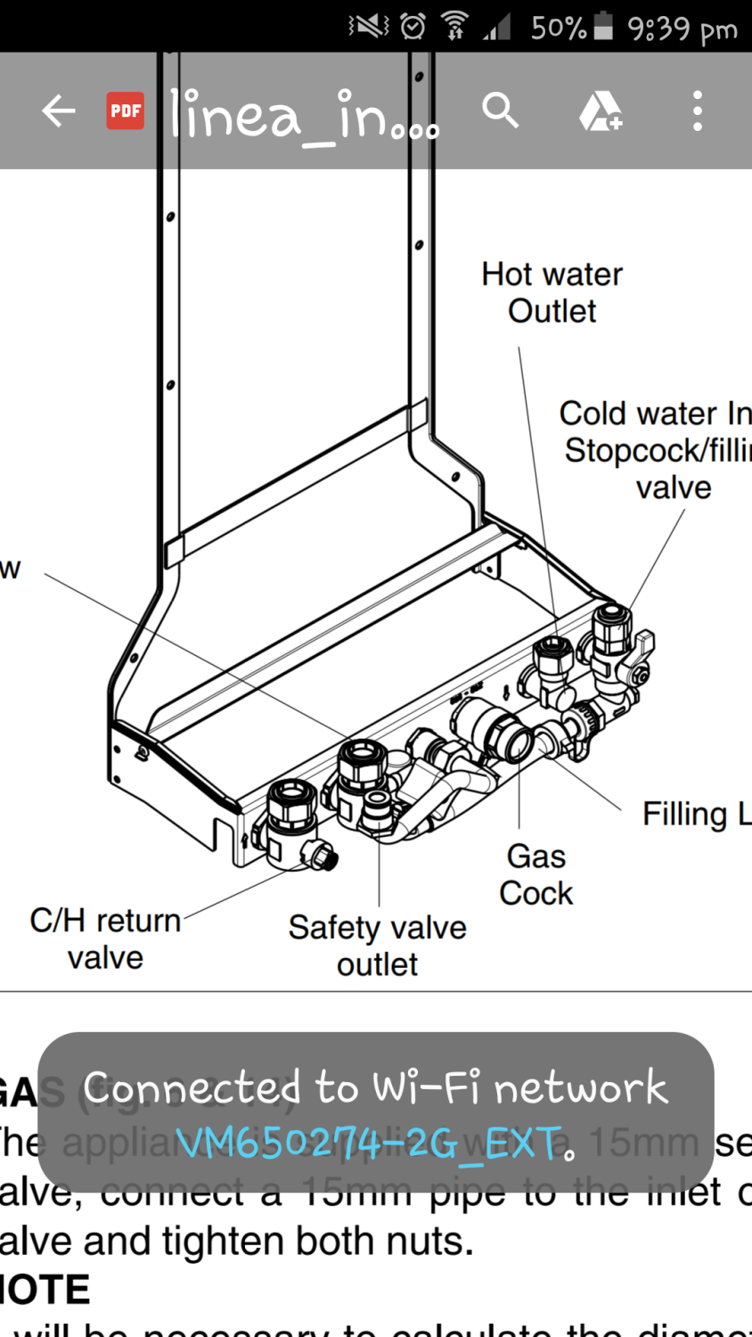

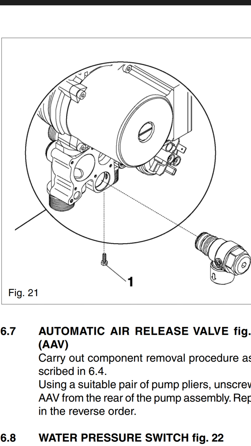

Re: Boiler on the blink, help needed :) - sinto607276 - 01-02-16
Scratching head.......
Been talking about *Pressure Release Valve* (PRV)
Manual I downloaded says *Automatic Air Release Valve* (AARV)
But picture in manual says CH Return Valve
(See pic attached)
Totally confused as to what to order now Sad

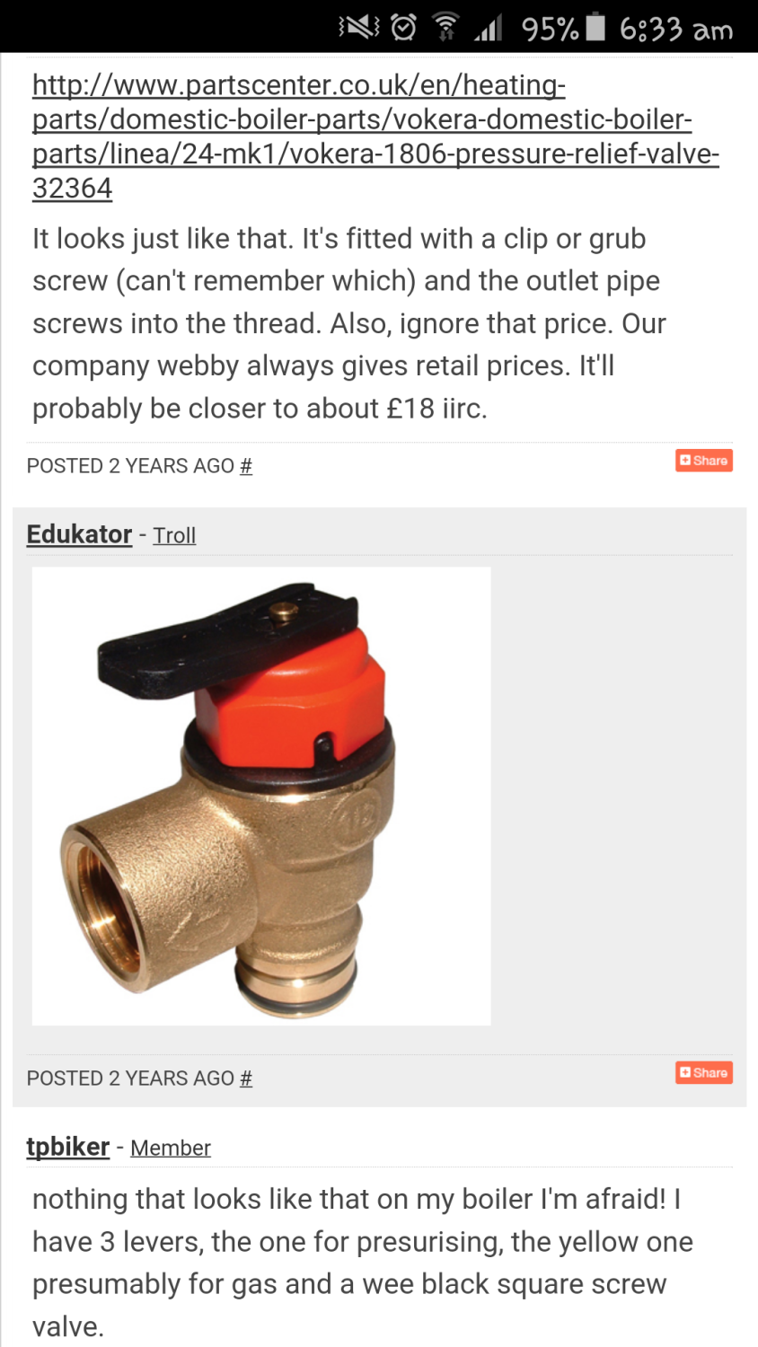

Re: Boiler on the blink, help needed :) - evesdad - 01-02-16
Have a look for makers part number 1806  its on a different picture to the one you are looking at, one end of it fits on to the safety outlet pipe in your picture.  Sorry I can't copy the picture from my work laptop onto here. key number 27 in parts diagrams.
Re: Boiler on the blink, help needed :) - chaz - 01-02-16
The AARV should be at the top of the heat exchanger, it might have a knurled knob that must be loose so that any air in the heat exchanger can vent, The PRV is the safety valve, so if the presure rises to 3 bar it vents to the outside , the other valves are service valves and can be closed so you don't have to drain the whole system, if you close them make sure they are open before pressurising the system (I dont know how or when you do the expansion vessle?) the filling loop is used to fill the system to 1 to2 bar.

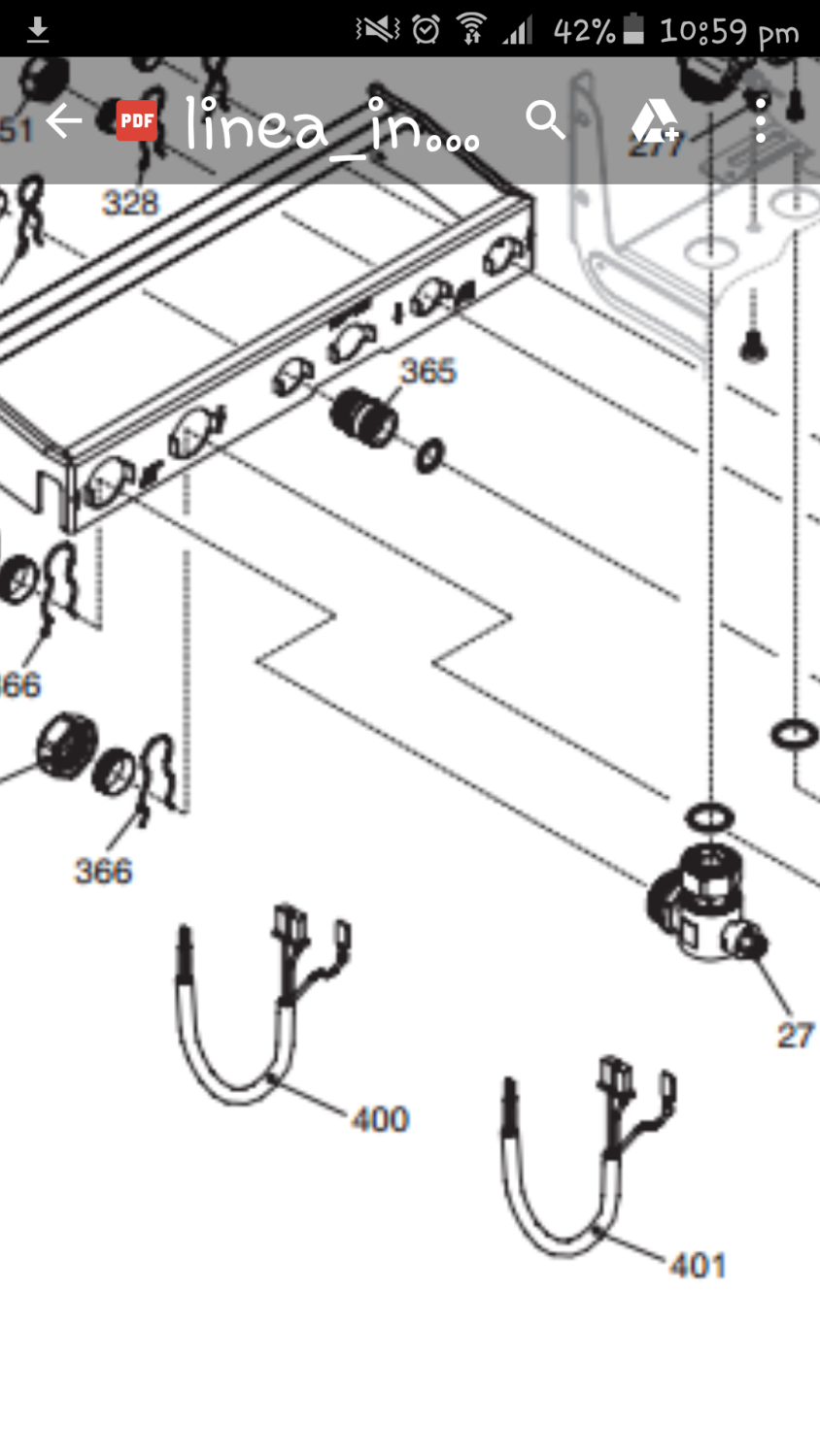

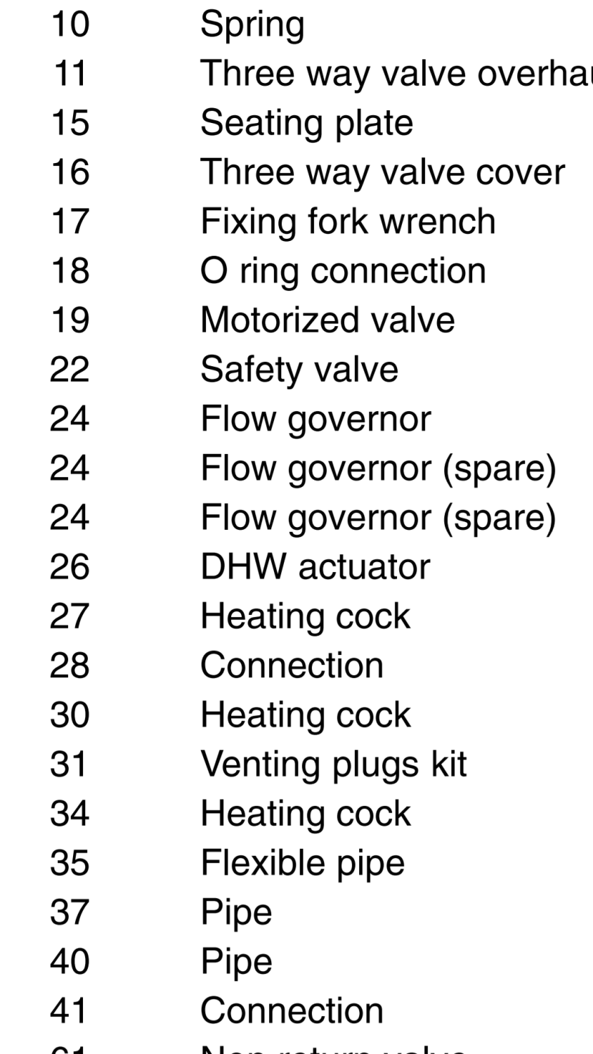

Another pic (pic1)
I presume were talking about the one on the left?
Checked that number 27 (pic2) it's called a HEATING COCK (pic3) on the manual!
This is screwing me up :eek
I really do appreciate your time and effort in helping me but I'm just getting really confused and scared of buying the wrong part Sad

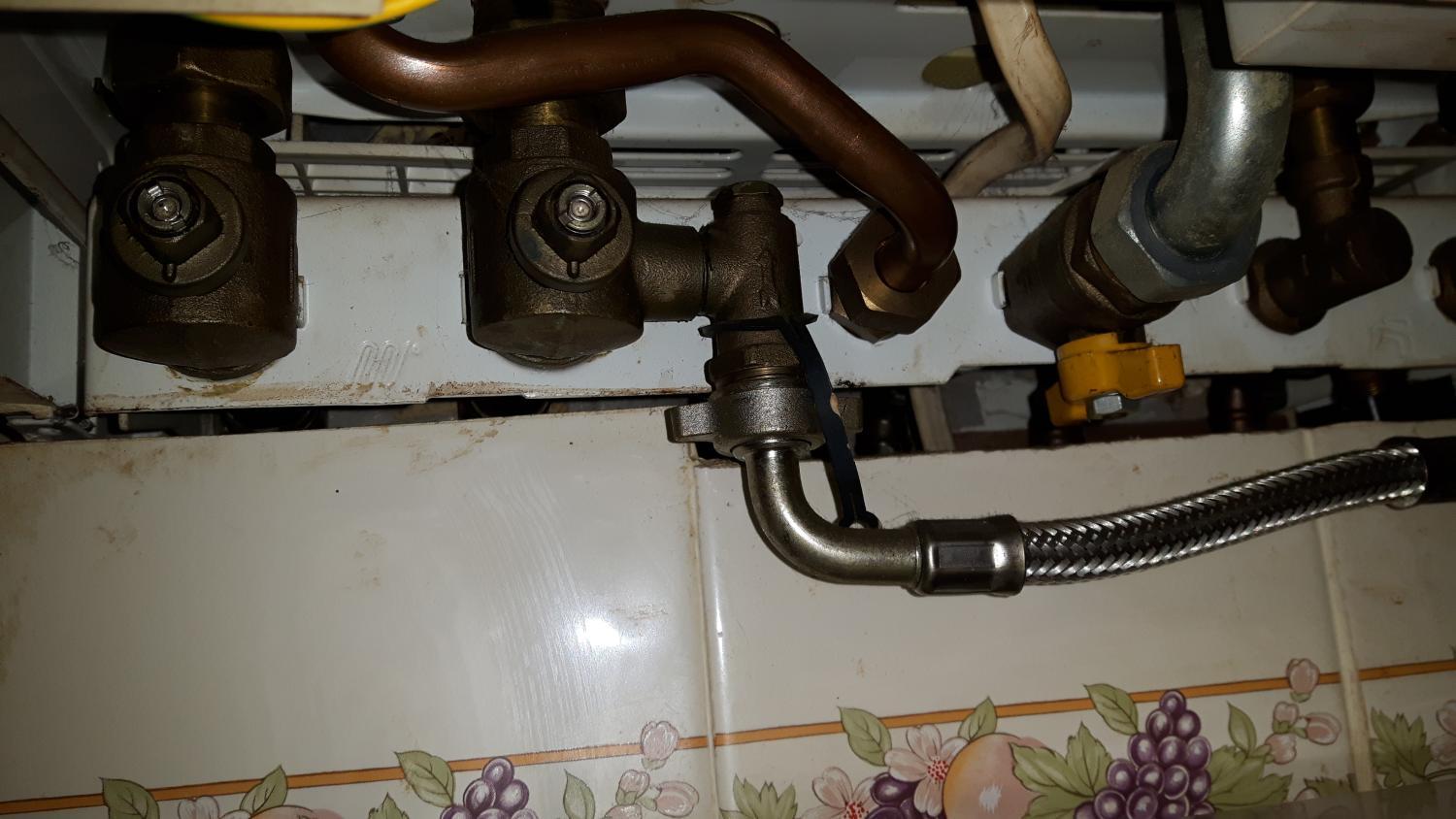

Re: Boiler on the blink, help needed :) - sinto607276 - 02-02-16
Thanks evesdad, thanks your help.
Should I be replacing pic1?
To stop it dripping water out the pipe to the outside?
I'm guessing I just need to drain the air in the vessel at the valve on top, replace this part (pic2) and pump up air in vessel again?
Therfore no water being lost via the boiler when I do this?
