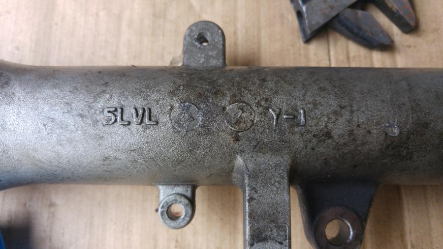

So, I found the guide for fork seal replacement and thought great, I've got a guide, I've Don fork seals before, shouldn't be a problem. Got the bike on a stand, got a fork out and opened it up. THESE FORKS LOOK  NOTHING LIKES THE ONES IN THE GUIDE.
I'm stuck, has anyone else seen these and done a seal change on them?
Re: Help! Fork seal replacements - PieEater - 23-01-16
Don't know what guide you are following but those look like the correct forks for the bike, I followed the Haynes manual when I serviced mine. What bit are you stuck on?

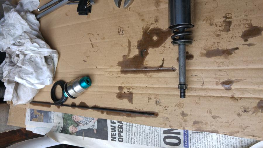

Well when I pulled the internals out they came out all in one piece
(23-01-16, 07:24 PM)tomsmith051 link Wrote: Well when I pulled the internals out they came out all in one piece
From your second picture where you have taken the top off and removed the thin adjuster rod measure the position of the locknut on the damper rod so you can put it back to the same place later then unscrew it, remove the spacer and washer then the spring will come off.
Thanks, I'll give that a go tomorrow
