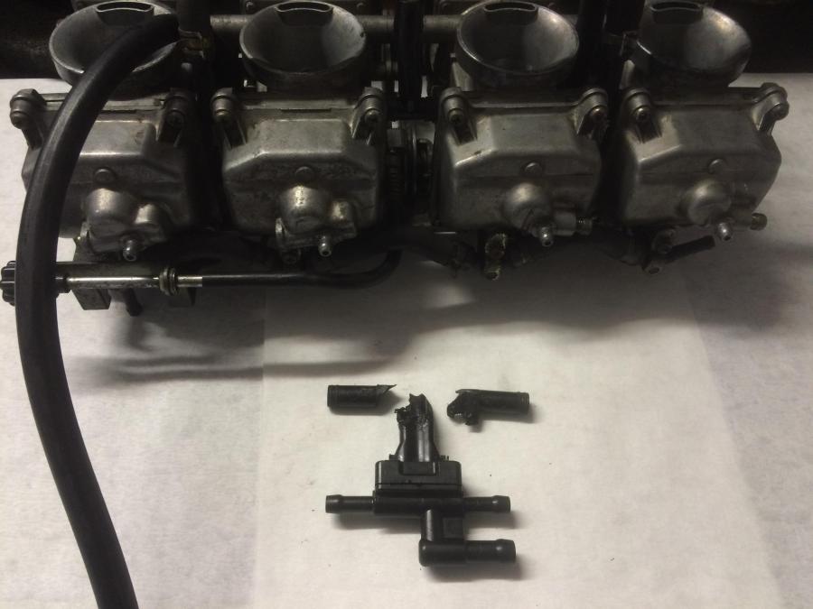

It's a plastic 5 way junction , how do I add photos on here? I have ordered one
Re: Idling trouble - jackson1995 - 26-01-16
Go it. This is the pipe

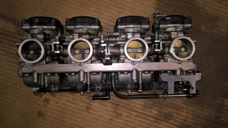

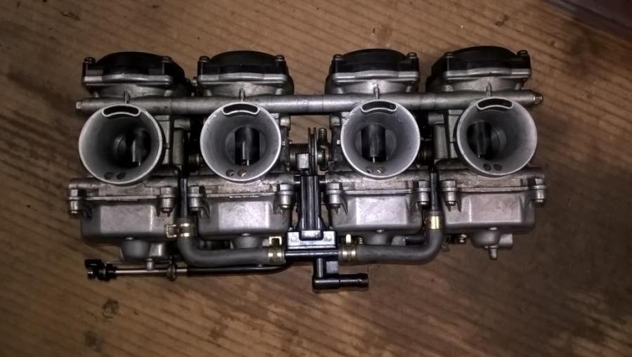

Re: Idling trouble - unfazed - 26-01-16
I have a full set of 400 carbs with a part of the choke housing on number 3 broken, but everything else is intact including that 5 way pipe.
You can have the full set for £60 incl postage
