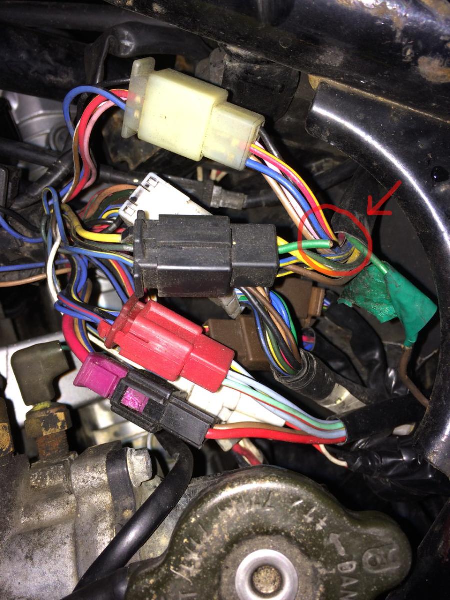

Hi guys, more pestering - this time electrical - thought I'd ask before breaking an open door... I've got no tail lights on when switching them on - front works fine, nothing on the back. When I press any of the brakes all the lights switch on, brake, tail light and numberplate light - all lit up when I press front or rear brake (this wasn't happening with front brake, but the cables were disconnected from the switch). I've attached a photo of a wire cut - it is (I think) for the double light mod - could this be the culprit? It was bastardised a bit, so can expect anything here I guess...
Re: Rear light cluster issue - bandit - 10-01-16
Looks like someone has cut into the green wire with the brown for the headlight mod as you said,looks like you need to reconnect the green wires to get the normal light setup.I'm guessing the brown wire connected to the green goes to the back of the headlight bulb connector if this is reconnected  the green the headlight mode should work. Smile
Also check the tail light bulbs as it is a double element & the one for the rear maybe blown.Bulbs required is a 12v,21/5w make sure you get the ones with the offset pins on bulb base.
Re: Rear light cluster issue - sinto607276 - 10-01-16
I would agree the green wire has to connect to the other green wire/brown wire combo (I'd personally strip all wires back, solder and heatshrink them as the pic shows bad workings) and I'd check all other wires :b

Re: Rear light cluster issue - aquilaalba - 10-01-16
Right, will check the bulbs tomorrow, will get the wires soldered together (green to join other green and brown). This is why I've asked, I thought that there is separate bulb for the numberplate and it's an earth issue that the earth is being cut off and when connected lights it all up, but from what you've just said it makes more sense. Plus an offset pin might be in the wrong place and has no contact maybe. Will check if the voltage is going to the contacts for lights when I switch the lights on, any chance that the green wire was the culprit and was suppose to power the tail lights? Will check and measure few things and let you know tomorrow. Bit tempted to wander off to the workshop tonight...  :rolleyes Big Grin
(10-01-16, 11:18 PM)aquilaalba link Wrote: Right, will check the bulbs tomorrow, will get the wires soldered together (green to join other green and brown). This is why I've asked, I thought that there is separate bulb for the numberplate and it's an earth issue that the earth is being cut off and when connected lights it all up, but from what you've just said it makes more sense. Plus an offset pin might be in the wrong place and has no contact maybe. Will check if the voltage is going to the contacts for lights when I switch the lights on, any chance that the green wire was the culprit and was suppose to power the tail lights? Will check and measure few things and let you know tomorrow. Bit tempted to wander off to the workshop tonight...  :rolleyes Big Grin
Yes the green wire is the rear light source and the brown wire looks like it's the front light mod (to get the two front lights working at the same time)
If your getting the brake lights coming 9n when you press the brakes I think you'll be fine with the bulbs being OK but if not it's just lift the seat reach to back and remove/replace either bulb which is a standard stop/tail dual element bulb available at Halford and the like and they come with offset pins so should just slot in no problem Smile
But after all this I'm guessing you connect the green wires together and trace the brown wire to the front right light as you sit on the bike and my thoughts are once they're all connected you'll have lights all round and working correctly Smile

Re: Rear light cluster issue - Deefer666 - 11-01-16

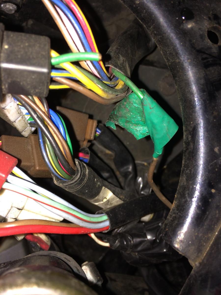

Have you checked the fuses? that is a shitty job of the headlight mod but why insulate the bar cut wire there is nothing going into it at the other end. All I would do is remove the green tape (WHO THE FUCK USES GREEN INSULATION TAPE?) and re-insulate it with some heat shrink.
Re: Rear light cluster issue - sinto607276 - 11-01-16
(11-01-16, 01:43 PM)Deefer666 link Wrote: there is nothing going into it at the other end
I can see a black wire coming out the other end of the block between the yellow and the blue wires but I'm not sure if it's where the green wire is connected to :b but if it's not connected to anything I agree, no point giving extra work for nothing Smile

Re: Rear light cluster issue - aquilaalba - 11-01-16
Right, as per photos - soldered the dodgy bit, will wait for amalgamate tape to get it properly insulated, didn't resolve the issue. As for the lightbulbs - did check them, bodge is an understatement, never seen anyone that stupid (well, not never, but for a long time...)... Please see second photo. Bulb replaced, yet it doesn't work. Is there a fuse in line as the wrong bulb would probably blow it? Will check the whole thing tracing from start to finish I guess...
(11-01-16, 10:41 PM)aquilaalba link Wrote: Right, as per photos - soldered the dodgy bit, will wait for amalgamate tape to get it properly insulated,
heat shrink then amalgamating tape over for real protection, but nether waiting till you've sorted the workings first
That's maybe because you didn't connect both the green wires with the brown one?
As above! And did you replace with stop/tail bulbs? (Even then they probably won't  work if you haven't joined those wires together, forget the brown wire for the time being and just do the greens together in case the dipped bodge job is shorting it!

I have joined the green wires and soldered brown one to them - just checked the photo and yes, you can't see it, but I did. Smile Stupid angle to take the photo though, I admit. Will check the fuses, if it comes to worst - I just need to run one cable from the headlight to the back to resolve it for now or trace it back to the origins and run it from where it starts (or should start). Brake lights are working, number plate light is a by-product of tail lights, if there should be two bulbs lit then it will be. Will try to check it tomorrow. Did discuss bringing bike to the living room for few days, until I get this sorted, but lost the vote... Smile)
Re: Rear light cluster issue - unfazed - 12-01-16
The second photo shows the most likely reason. Indicator bulb in the Stop and Tail Light bulb holder. Get a stop and tail light bulb, it will have two filaments in it and two connectors on the end to match the one in the holder. Bulb will only fit one way due to offset locators in the holder and the bulb
Re: Rear light cluster issue - aquilaalba - 12-01-16
I should have mention this in the first place - I've replaced it with an automative bulb - slightly different as the contacts are more oval than round, but fits only one way and has two filaments. Still no joy. I thought that because if there was improper bulb fitted then there would be no continuity in the circuit - hence no light due to the fact the circuit is not closed. Will try to get at it today as soon as I'm done with all the work scheduled.
It's alive, it's aaalivee...!!!!!! Hi all, found a fuse hidden inside the fairing on the left side of the bike (pictured), insulated the green / brown wires (earth anyway, no current through them) and - hallelujah! I've got the tail lights which means that the bike is fully (I hope) operational - which means further testing it to see if there are any more bodges hiding. Hopefully not. Thanks for your help!
