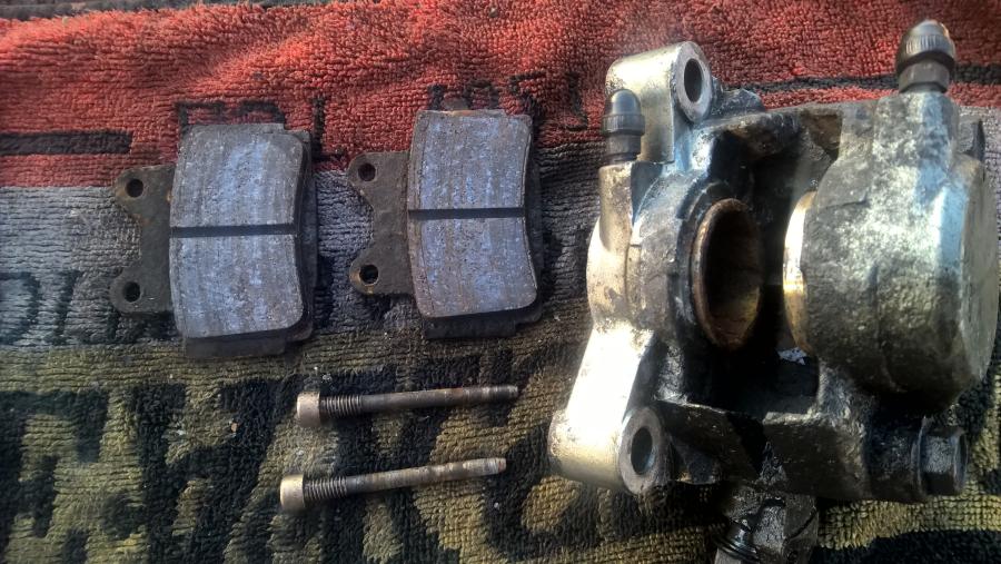

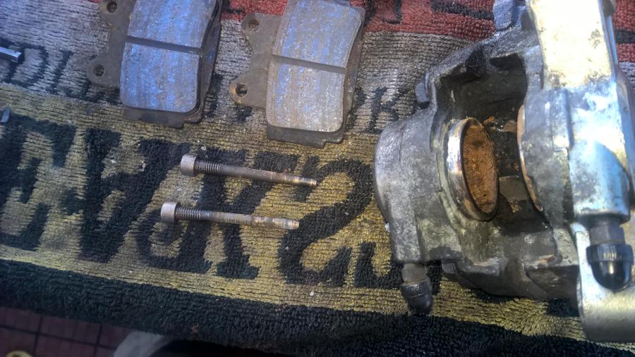

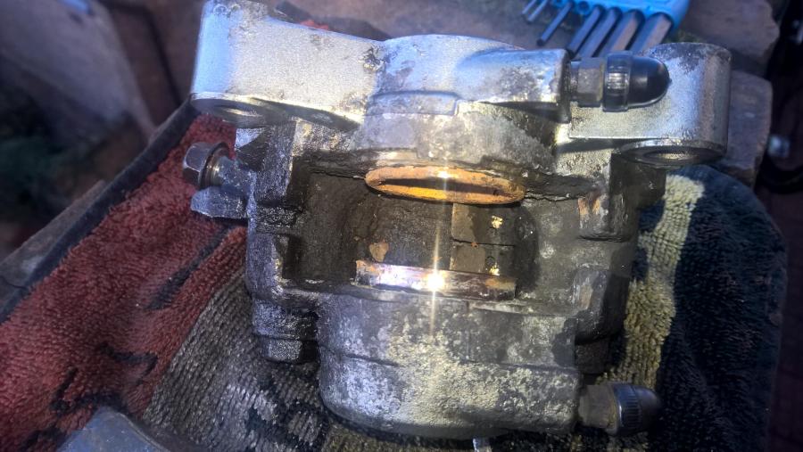

My rear brake seizes every winter, but frees up with use. I should have serviced it ages ago, but finally took it off today.
One piston moves with force, the other is stuck. I could probably free things up with penetrating oil, a soak and a clean but am I wasting my time?
Is it a case of "new seals, it'll be fine" or "bin it and get a new one"?
I would obviously prefer to fix it on the cheap, but is it a false economy?

Re: is this rear caliper salvageable? - Gnasher - 29-12-15
From what you've posted it needs some TLC just a rebuild should do the trick.
Re: is this rear caliper salvageable? - Deefer666 - 29-12-15
It depends, I have had a few lately that as you clean them up the corrosion has eaten away at the
lip that holds the dust seal inon the inside piston. I would say that you need to get the pistons out, clean it up and then check the caliper body. If its all still good then rebuild it.

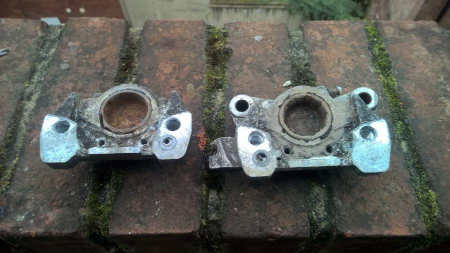

Re: is this rear caliper salvageable? - Bretty - 29-12-15
Well I couldn't push the pistons out, as there is now air in the brake line. I probably should have bled it and persevered, but instead have split the caliper.
The outer seals look knackered for sure, and pistons are pretty corroded on the inside. I have no idea how to get the pistons out now, but for the cost of new pistons and seals I might as well hunt for a half decent secondhand caliper....

To answer my own question. No... no it's not salvageable. Both seals seem to have extruded out the gap bringing bits of the casing with them.
I thought it was a bit sticky.
Re: is this rear caliper salvageable? - Deefer666 - 30-12-15
Yup, That's fucked
