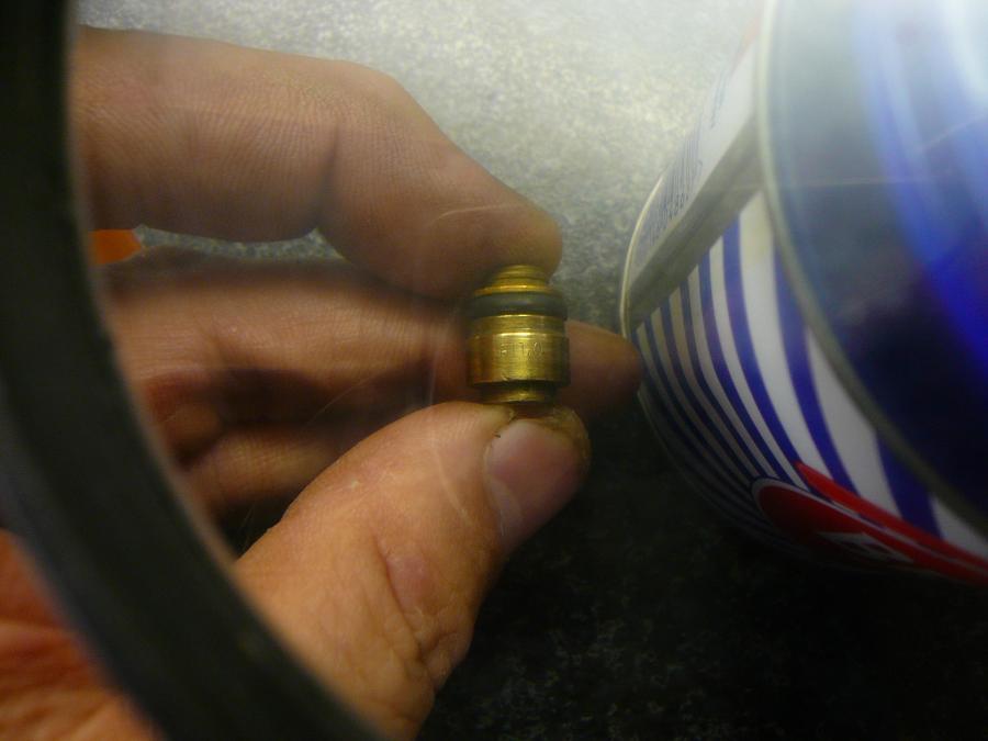

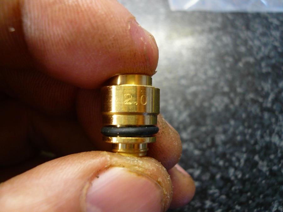

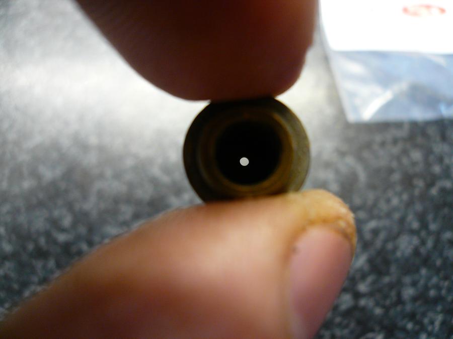

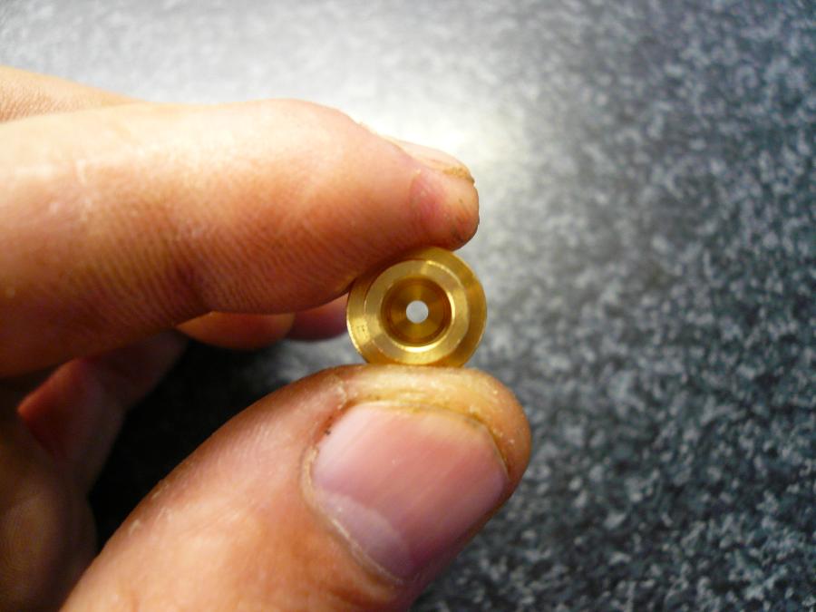

CARBURETTOR FLOAT NEEDLE VALVE SEAT - IMM - 19-10-15 Can anyone help me out on this one i have purchased a needle valve and seat for my FZS 600 2000 model, on receiving the new replacement i have found that the hole in the new one {where the needle seats} is bigger than the original would this or will this make any difference at all? Please see pictures Re: CARBURETTOR FLOAT NEEDLE VALVE SEAT - His Dudeness - 20-10-15 I could be wrong here but I don't think you can take the seat out on fazer carbs so I'd say you've got a seat off another set of carbs Re: CARBURETTOR FLOAT NEEDLE VALVE SEAT - IMM - 21-10-15 Hi [size=1em]His Dudeness[/size] I have two bikes the same and three sets or carbs and they are all the same thank you for you post though the headache goes on lol Re: CARBURETTOR FLOAT NEEDLE VALVE SEAT - Fazerider - 21-10-15 So long as the new one fits, there shouldn't be a problem. It'll be able to fill the float bowl faster but that won't affect the final mixture fed to the engine. Remember to check the fuel level is correct. Re: CARBURETTOR FLOAT NEEDLE VALVE SEAT - His Dudeness - 21-10-15 So they can be removed on fazer carbs? Re: CARBURETTOR FLOAT NEEDLE VALVE SEAT - Fazerider - 21-10-15 (21-10-15, 09:03 AM)His Dudeness link Wrote: So they can be removed on fazer carbs?Yes. They're held in fairly tight by the O-ring... which I've known to fail and cause carb flooding. |
