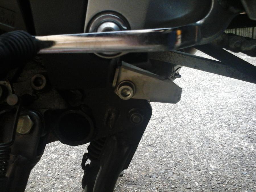

Re: Centre stand for Fz1N - Smurfbud - 13-10-15 So what was the initial problem? My FZ1-s has centre stand mounting points on both sides of the frame. I take it your FZ1-n doesnt??? So where did you mount the accompanying centre stand bracket your local breakers provided? Pix would be good Re: Centre stand for Fz1N - Mike01 - 13-10-15 (13-10-15, 07:49 AM)Smurfbud link Wrote: So what was the initial problem? I had no bracket on the off side, the sandwich type plate came from a 1s and bolted straight on. The near side mounting point was there already. Re: Centre stand for Fz1N - Mike01 - 31-10-15 Sorted ![]()
Re: Centre stand for Fz1N - slappy - 31-10-15 Got the same on my FZ1S , fitted an Akrapovic the other week and it was included in the fitting kit. Nice and tidy instead of an ugly bracket welded onto the llink pipe
Re: Centre stand for Fz1N - Mike01 - 31-10-15 Cost a few £££ but it's nice and tidy 8) Re: Centre stand for Fz1N - slap - 18-12-15 Hi, I have a FZ1n ABS & have fitted a centre stand no problem. All the mounting points were there to bolt onto, only 1 bolt hole was used for the ABS cable so had to re-route that cable. Centre stands are a "blessing" on long tours when chain lubing is needed. Re: Centre stand for Fz1N - Doovy - 26-01-16 (12-10-15, 07:20 PM)Mike01 link Wrote: Now have one ordered, bit of a wait as they are made to order but that's ok by me On this occasion, I would be that poor focker..!! I have just signed up to this site as I was on the search for the same centre stand stop bracket for my FZ1, and have also ordered one from Performance Parts! Thanks for the headsup (and sorry for thread revival!) Re: Centre stand for Fz1N - Mike01 - 26-01-16 (26-01-16, 02:47 PM)Doovy link Wrote: [quote author=Mike01 link=topic=18424.msg212947#msg212947 date=1444674036] On this occasion, I would be that poor focker..!! I have just signed up to this site as I was on the search for the same centre stand stop bracket for my FZ1, and have also ordered one from Performance Parts! Thanks for the headsup (and sorry for thread revival!) [/quote] :thumbup :thumbup :thumbup |
