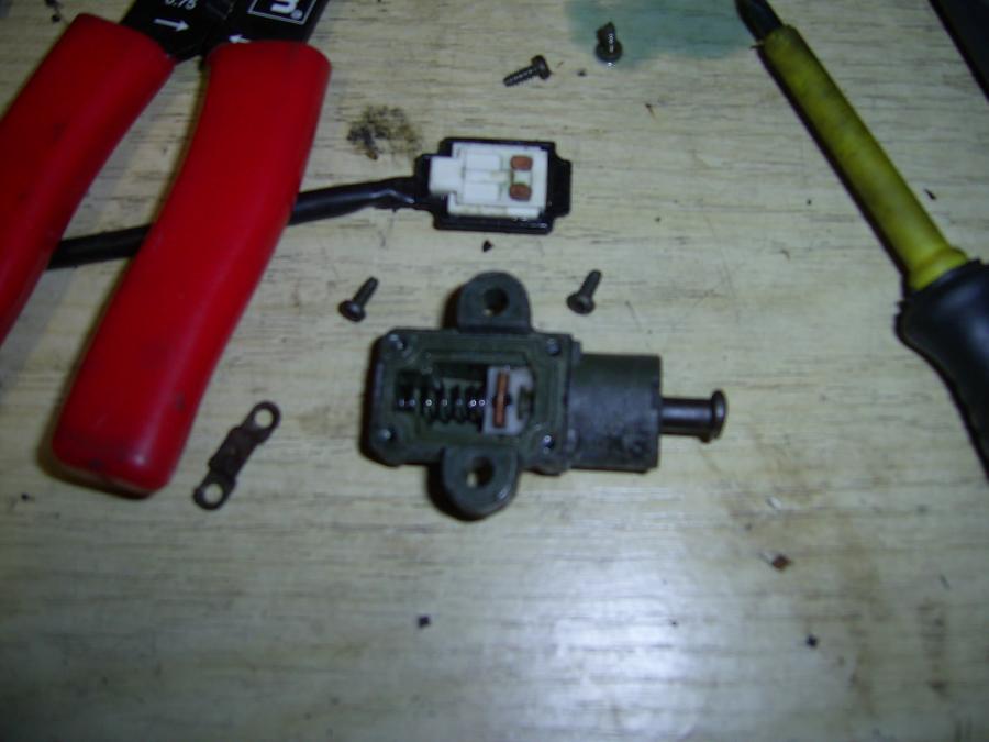

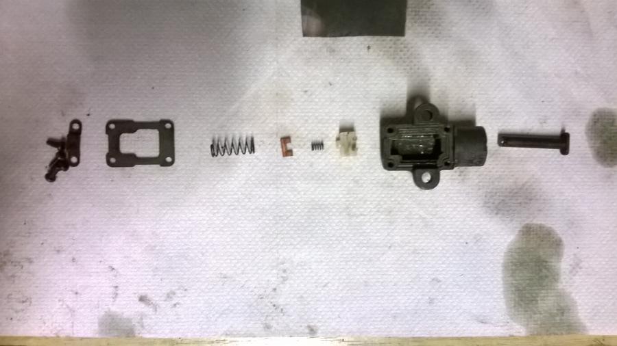

Re: pressed the starter and nothing nada zip diddly squat! - unfazed - 20-09-15 Did the solenoid click when you pressed the button? If it did then it is most likely corrosion of the large contacts within the solenoid. It can be opened and cleaned if necessary. Re: pressed the starter and nothing nada zip diddly squat! - nickodemon - 20-09-15 No click. If it had clicked i would know it was the solenoid. When pressing the starter button there was absolutely nothing. The neutral light didn't fade, so no power was being used. Re: pressed the starter and nothing nada zip diddly squat! - nickodemon - 20-09-15 I will check the sidestand switch tomorrow. I noticed with the stand down and put into 1st gear the bike didn't cut out, so i will need to check if it's disconnected and wired to eliminate it.. Re: pressed the starter and nothing nada zip diddly squat! - PieEater - 21-09-15 Have you had the battery on charge? It doesn't take a great deal of juice to keep a neutral light bulb lit. Re: pressed the starter and nothing nada zip diddly squat! - nickodemon - 21-09-15 It's not the battery. Re: pressed the starter and nothing nada zip diddly squat! - nickodemon - 21-09-15 I followed the sidestand cut out switch wiring, which goes into a dark blue block connector behind the left hand side panel. It is plugged in, so it hasn't been disconnected or rewired to eliminate the side stand switch. The sidestand switch doesn't work, as if sidestand down and put in gear the bike keeps running, so its faulty. How come when it's unplugged the bike does not cut out when in gear, as i seem to recall you have to bridge the wires to eliminate the switch? Or do you simply disconnect it? Re: pressed the starter and nothing nada zip diddly squat! - unfazed - 21-09-15 If the side stand switch was faulty it is unlikely the bike would run at all unless it is stuck in the side stand up position. The side stand supplies an earth to the ecu via the ignition key and one of the alarm loop plugs under the seat. Easy to test the side stand switch if you have a meter. To determine which model Gen 1 you have do your lights 1.Switched by a switch on the right handle bar 2.On all the time 3 Come when the bike starts Re: pressed the starter and nothing nada zip diddly squat! - nickodemon - 21-09-15 They are switched by the r/h switch. Tested the sidestand switch and there is no continuity between pins with sidestand up or down (faulty). Clutch switch gives no continuity with lever out and continuity with lever pulled in (correct). I also tested the starter cut off relay between the blue/white and black and no continuity(correct). If i unplug the sidestand switch it makes no difference, but it should.... because if its unplugged the bike will think the stand is down. The bike is starting with it plugged in and when it's unplugged? Re: pressed the starter and nothing nada zip diddly squat! - unfazed - 21-09-15 Blue/white and black are 2 separate circuits ??? Blue/white goes to the neutral light and the black to the earth from the starter button ?? Re: pressed the starter and nothing nada zip diddly squat! - nickodemon - 21-09-15 haynes manual states to check operation of relay set to continuity between blue/white and black(europe models). No continuity should be shown Re: pressed the starter and nothing nada zip diddly squat! - unfazed - 21-09-15 Just looked at the Haynes manual and don't know why they recommend that test as there are no diodes connected across the relay contacts, and if the diodes were and had broken down the starter cut out system would never work. Was wondering why your were doing that test and reckoned it was the light blue/white of the neutral wire and you were testing the neutral switch. If the side stand switch has no effect it must be bypassed somewhere along the circuit. Will the bike start in gear or do you have to have the clutch pulled in to start it. Side stand switch is easily fixed see pics. Clean the copper contacts on the plate and the copper piece in the housing and treat all with WD40 before you put it back together. I took out the plunger and greased it also. Re: pressed the starter and nothing nada zip diddly squat! - nickodemon - 21-09-15 Bike starts in gear clutch in or out. I also disconnected the clutch switch and the bike started with the clutch lever in and out? Re: pressed the starter and nothing nada zip diddly squat! - unfazed - 21-09-15 Check under the seat to see if they have rewired the loop plugs to provide a permanent earth to the ecu and starter cut out. There are two 4 way plugs with one loop of wire in each. One is the sidestand cut out and the other the starter cut out Re: pressed the starter and nothing nada zip diddly squat! - nickodemon - 21-09-15 loop plugs? Re: pressed the starter and nothing nada zip diddly squat! - unfazed - 21-09-15 Yes, two loop plugs Lift the seat and on the left side where the wiring loom is you will see 3 plugs a 3 way off white one a 4 way off white one and a 4 way black one The two 4 way ones should have wire loops see pic. |
