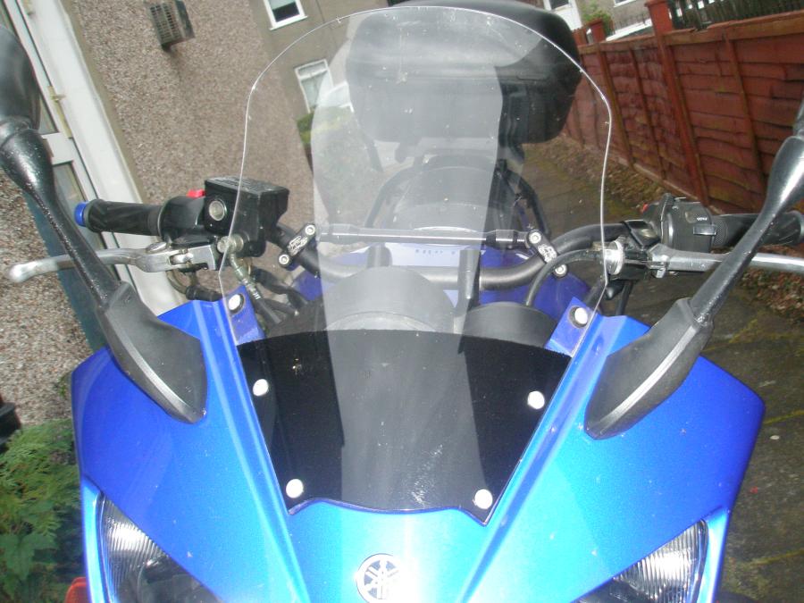

Re: Oooops I've bought another gen 1!!! - nickodemon - 20-09-15
Its an excellent screen. I can sit at 80mph with no head buffeting at all. Here's a pic
Re: Oooops I've bought another gen 1!!! - JKay - 20-09-15
Wots the make of the screen pls m8
