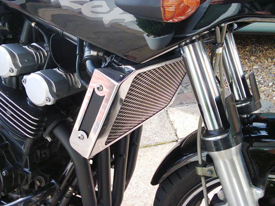

I have tried to add new rad cover. 3 bolts have untighten fine. The 4th one - another bolt foccup.
First the hex key has twisted like spaggeti  :eek , the second 4mm hex key bit I just bought from Halfords has drilled the bolt  :'(
See pictures. Any ideas how I can fix that? I have applied industrial amounts of WD40 and penetration fluid before the final attempt to no avail.
Do I need to go to the nearest machinist shop for help?? Is there any easy way to unscrew that bolt?
Note the bolt goes into the side of the radiator which looks to me some sort of hard aluminium alloy, the bolt is steel. It is tighten so hard looks like melded.
EDIT: just reading some horror stories aparently steel bolts can be fused with the aluminium through galvanic action. Seriously guys?  :wall
[Image: k9a04o.jpg]

I have tried Torx harmless approach as proposed by a guy on some other forum and it worked thank you Lutin for your help  :thumbup
Bought for £4.61 set of good hard steel [url=http://"http://www.amazon.co.uk/gp/product/B000LFTRYE?psc=1&redirect=true&ref_=oh_aui_detailpage_o00_s00"]Torx bit sets[/url] yesterday.
They have arrived today. I have embedded T27 which is 5mm but has managed to tap it in 4mm hole with the hammer. I was a little pissed off so may have not been so gently as advised.
Anyhow after soaking with penetration fluid and waiting for 2 hours for my radiator to cool off after the ride, I have tried using about 1 foot long arm doing most of the pressure pressing with my right hand towards the bolt and actually untightening very little with my left hand. It bulged half a mm. I have tighten it back. Than untighten again a little. You got the mood.
It worked ;D
I have new ugly radiator cover mounted! Ugly because the fit was not ideal and it bend. Frankly I do not care  :lol

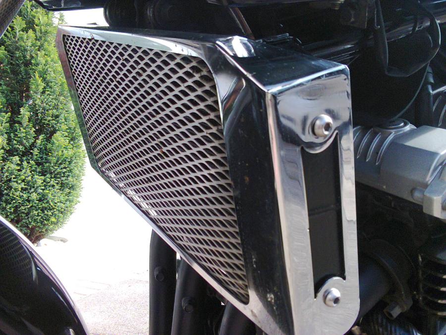

[Image: 207axzp.jpg]
Re: another bolt focc-up ideas? - 7omly - 10-09-15
With regards to the bend, this happened when I fitted a replacement. I took it off and put a couple of washers on the inside of the mounting points, (bloody tricky) but it took the bend out.
Re: another bolt focc-up ideas? - joebloggs - 10-09-15
(10-09-15, 09:01 PM)7omly link Wrote: With regards to the bend, this happened when I fitted a replacement. I took it off and put a couple of washers on the inside of the mounting points, (bloody tricky) but it took the bend out.
If you want to do this mark the position of the screw head on the out side of the cover, remove it, araldite the required amount of washers together, put a nut on the back of the screw, araldite the washers to the back of the panel, leave to set.
Simples.......
Re: another bolt focc-up ideas? - fazersharp - 12-09-15
Under your new one it looks like there is already a mesh or is that part of the new one.
I got this one off ebay and fully expected to have a faf fitting it as everyone seems to, it like different year rads are different sizes but all covers are one size.
Any who it was a perfect fit, I dont much care for the ones that say fazer as I think it looks a bit teenage boy racer  :evil :pokefun
