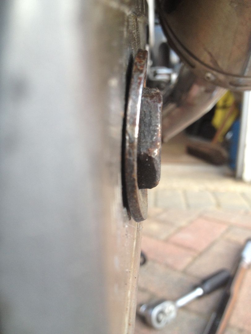

OK, I got a new washer for the offside of the axle from a chap on here.  Took axle out and put the new washer on and when I looked it looked like this
[Image: IMG_2070.jpg]
The one on the nearside sits totally flush, surely it shouldn't be bending like this?
I used my torque wrench (it's not the most expensive one, I got it from Argos) a few years ago and have used it for my rear axle for years (that's why I bought it).  I never had a problem with my first FZS600.
Anyway, I did it up to 117Nm and this is the result.  Doesn't look good does it?  Sad  Do you reckon it's ok to ride?  Obviously I need to sort it but how, not sure.
Cheers
Re: Rear Axle - red98 - 09-09-15
117Nm........you sure thats correct, sounds a bit high to me....
Re: Rear Axle - HarryHornby - 09-09-15
that's what it says in haynes
what do you do your one to red?
Re: Rear Axle - Val - 09-09-15
yes I've done mine to 117nm as per the manual too.
But your does not look right. Are you sure the torque wrench is calibrated?
Here how mine looks:
[Image: 2q208sn.jpg]
Dont use a torque wrench on the wheel spindle, iam old remember so do it by feel  Wink....just out of interest see if you can undo it with the spanner and extension in the bikes tool kit....is the swinging arm beneath the washer distorted at all ?.
Re: Rear Axle - celticdog - 09-09-15
Yep you've got a bit of plastic deformation there. Not to worry mines the same albeit not as bad as yours. The nut head's nicely rounded and a bit rusty too, might be time to replace the axle. You can't complain- she's getting on a bit in years.  :lol  Like red98 I also do it by feel.
Val, the torque wrench is a challenge one from Argos, has always been ok in the past, I always release the tension before putting away but I've never had it callibrated.
Red, yes the bits above and below the gap on the swing arm where the axle passes are distorted, were like this before I started fiddling.  The whole point of the fiddling was because I noticed my washer looked like a dinner plate, but nothing like it does now.
I don't think the washer I got off the chap on here was much cop though.  It was straight enough (unlike my old one) but it had deep pitting where the bolt on previous bike had pushed into it.  I turned it around so that part was agains the swing arm, I'm guessing it's thinner and weaker because of the deformation and so buckled worse than the old one.
Celtic dog, I was thinking new axle too, but I have to do everything on such a tight budget I doubt I could afford that, I tried to do it cheap and failed ha ha
I think I will take it all apart again but put the old washer on the other way round, see how that goes.  I'll only have until it gets dark tomorrow though, Saturday is fully booked up.  Don't want to miss another fazer ride out :-(

Re: Rear Axle - anutz - 09-09-15
so mine is done to 112Nm, i did not feel happy with that extra 5Nm  :lol
I am not sure why the washer on yours is bowed, has it been over tightened in the past?
I ask as i have in the past over tightened a bolt and the washer was the first thing to go....it bent....
Re: Rear Axle - stevie-g1968 - 09-09-15
My axel washers are like that and im not worried,  I use the feel factor.. 30years of swinging tools. Your end plates should not rattle... I ignore the alignment marks and measure the distance from the swing arm to rim... and a long straight edge to front wheel
Re: Rear Axle - darrsi - 09-09-15
The 'washer' is more for alignment purposes, be grateful your wheel is firmly tightened up and straight, that's all that counts.

Re: Rear Axle - HarryHornby - 10-09-15
I get that Darrsi, but, if it's bent like this surely it's putting strain on the edges of the gap where the axle goes through the swing arm, surely it should be flush to avoid damage to this area.

Re: Rear Axle - maxzer1500 - 10-09-15
(09-09-15, 09:18 PM)HarryHornby link Wrote: Val, the torque wrench is a challenge one from Argos, has always been ok in the past, I always release the tension before putting away but I've never had it callibrated.
grrrrrr
  If you reverse the washer it's probably only going to flatten then dish itself with the tightness of the spindle nut. My 600 was the same so think it's normal, if you're happy with tightness of spindle, alignment and chain tension, just leave it and deal with the real issue which is the sliders/end plates. With wheel tight, nip up the first adjusting nut by one or two flats each side. I find one turn is too slack and two is too tight so i go one and a half, in other words a flat to a flat then to the next corner. Just be sure to use two spanners to lock the two nuts together and there shouldn't be any later slackness.
