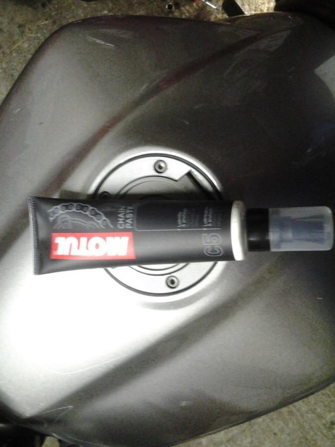

chain lube - red98 - 26-08-15
Been using spray lube for a few years now but never been really happy with it, so decided to try a paste, comes in a tube with a brush on so easy to apply and no mess, its like painting on a grease, just removed my rear wheel to replace the rear shock and theres very little lube on the wheel, think I'll STICK  :rolleyes with this now  :thumbup
Re: chain lube - slappy - 26-08-15
Never seen that before, where did you get it?
Re: chain lube - red98 - 26-08-15
Infinity motorcycles, think it was about £7.....I have one of their loyalty cards , even when I dont use it they send me a £10 voucher twice a year...pays for my lube  :thumbup
Re: chain lube - Rob R - 26-08-15
I love this product.
Hein Gericke used to sell the stuff. I bought 6 tubes in their closing down sale, I think they were half price, and am now down to my last one.
I'll have to investigate Infinity M/Cs.

Looks good Paul ill have to give it whirl :lol .
Re: chain lube - fazersharp - 27-08-15
BUT -- butty - but but. That just sticks on the outside doing - not a lot. The spray I use comes out almost liquid and runs in and around the rollers and links and then sets.

Re: chain lube - mark g - 28-08-15
I was gonna say I would have thought the paste stuff would just stop the chain from going rusty and do nothing to actually lubricate it properly??  :rolleyes
Re: chain lube - purplebear7 - 28-08-15
Grease and other Sticky Stuff will just collect (and hold) fine road dust and Grit  :\.
Grease and Grit make Grinding Paste !! :\
A Wet Chain is a Happy Chain ... Oil it ... Scottoiler's Rule ... Sorted  Wink

Re: chain lube - red98 - 28-08-15
some good points there and a reply from SLIMWILLY  :lol ....you can work the lube between the plates where it needs to be with the brush,takes longer compared to a spray lube but it stays on the chain longer.....been using it for 4/5 weeks now and chain still looks wet and clean.for £7 i think its good value  :thumbup

Re: chain lube - celticdog - 28-08-15
It's all about viscosity!
A low viscosity medium- thin oil, will allow maximum penetration :eek However it won't stick to the chain for very long, especially under high speeds and sharp braking conditions.
A high viscosity lube- e.g. paste, will stick to the chain well but won't penetrate as deep. However, the more you work the chain, the hotter it gets and the better the penetration  :eek.
It's a compromise, how often you want to lube and how much you want to spend. Some folks use old motor oil for cheapness or use chainsaw oil for maximum cling, it's a personal choice.
