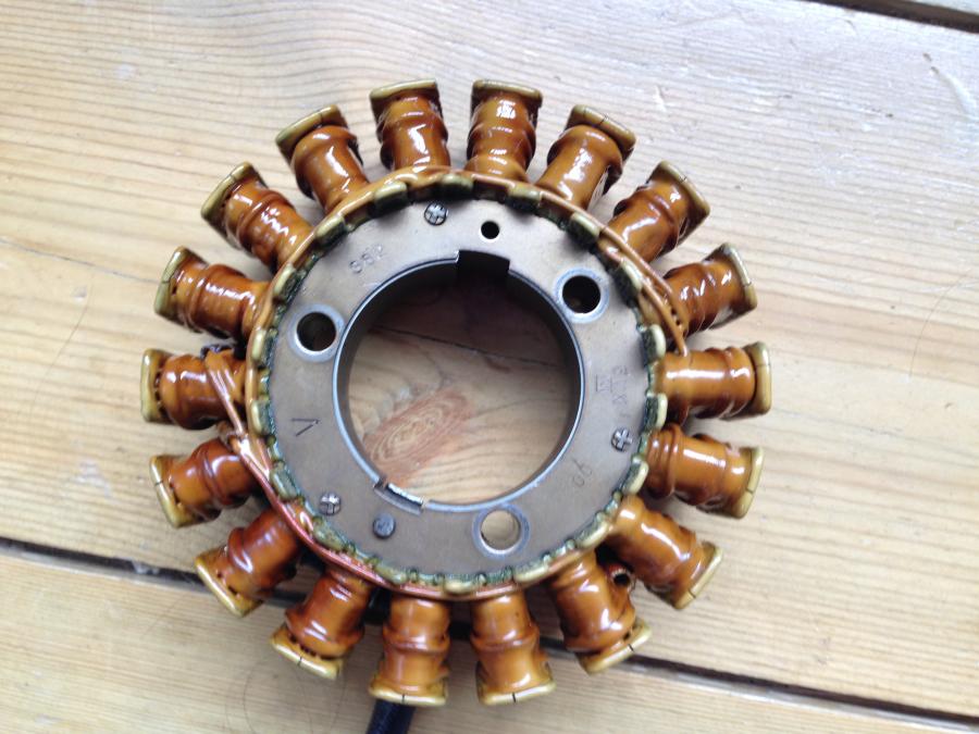

So then I thought that my stator/generator may have gone. So I removed that, but tbh it looks fine. There are scorched areas, and no areas that look particularly burned.
I am now wondering if I should get another stator/generator, or if the issue is something else. It can't really be anything else, can it? The system is pretty simple in terms of components. Perhaps a wiring issue? I am wondering whether I should put it all back together again and give it a try again. But I don't want to end up miles from home with the engine unable to start (again).

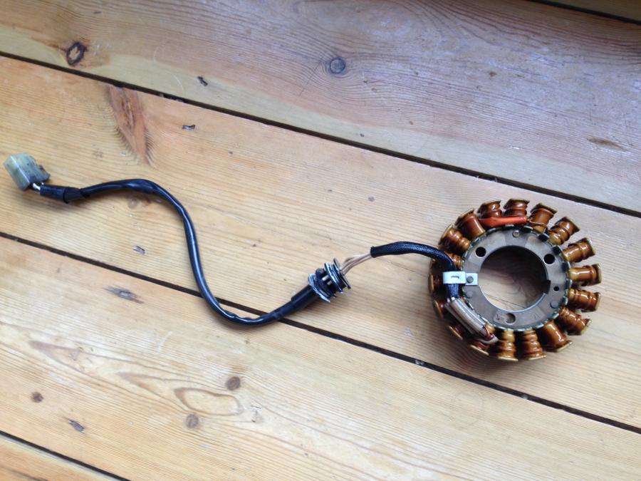

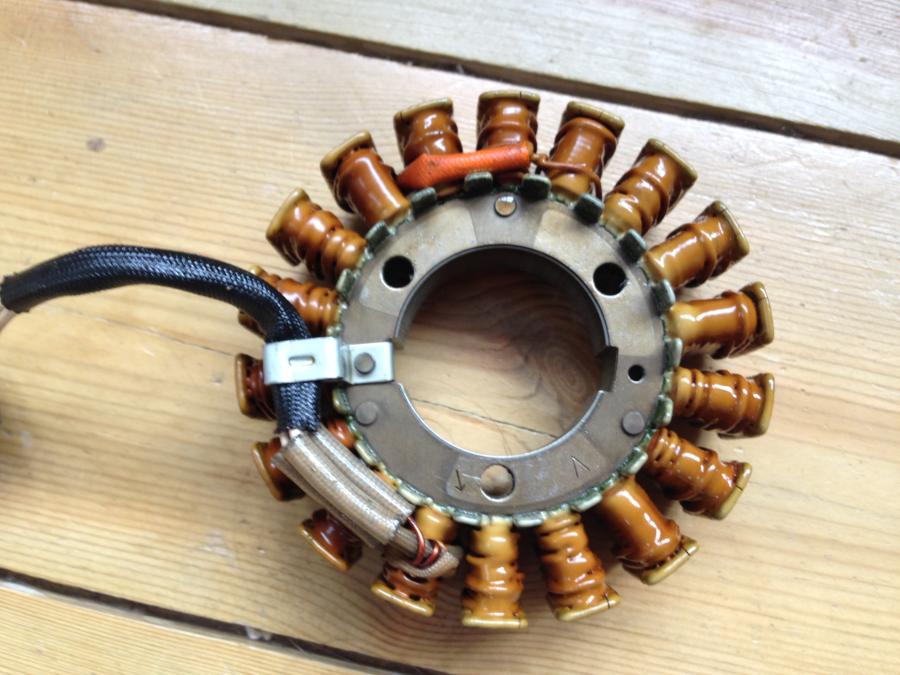

I have attached pics of the stator in it's current state. I have shown both sides. See what you think...

Anyone think the stator looks fried?  :o
Re: Electrical problems. Help!!! - slappy - 03-08-15
(03-08-15, 05:18 PM)RustyGubbins link Wrote: Anyone think the stator looks fried?  :o
Looks more like lightly grilled to me Smile

The generator doesn't look obviously bad. A resistance measurement between each of the white wires may tell you something, but some faults can fool that check.

The generator looks ok, but looks will not always show a dodgy connection or low insulation.
