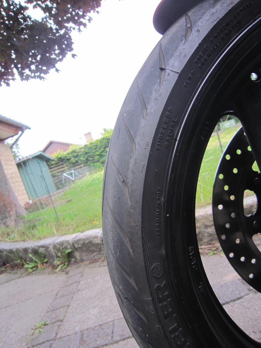

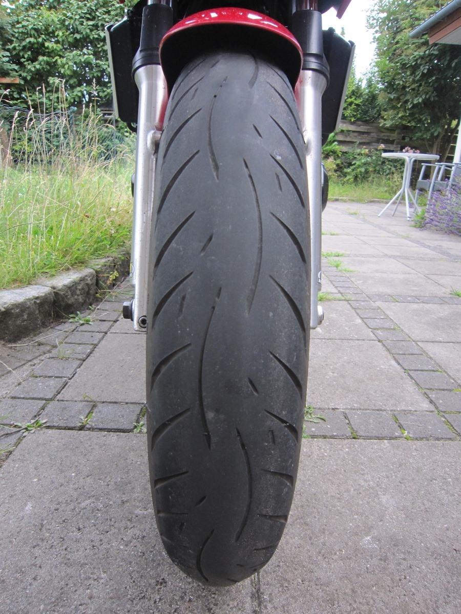

Re: Shaking Front Fork! - Frosties - 01-08-15
What condition is the front tyre in? Starting to square off? Cheap brand?

Re: Shaking Front Fork! - Bimbam - 02-08-15
Tyre is Metzler Roadtec Z8 110/70 ZR17 and it is to be changed soon.
I have done 15.000 km on the tyre and mabye the shaking is getting worse.

Re: Shaking Front Fork! - Bimbam - 19-08-15
New tyre fixed the problem!.
I got new Metzler SportsTec M7RR, front and rear.
Re: Shaking Front Fork! - darrsi - 19-08-15
(19-08-15, 04:43 AM)Bimbam link Wrote: New tyre fixed the problem!.
As tyres wear from new they will become slightly unbalanced over time, even more so if they're not wearing evenly for whatever reason.
Having a tyre/wheel balanced again half way through the tyres life would make perfect sense to compensate for the general wear and tear, but nobody ever really does this.
At least it's sorted now, and you got new tyres out of it too.
