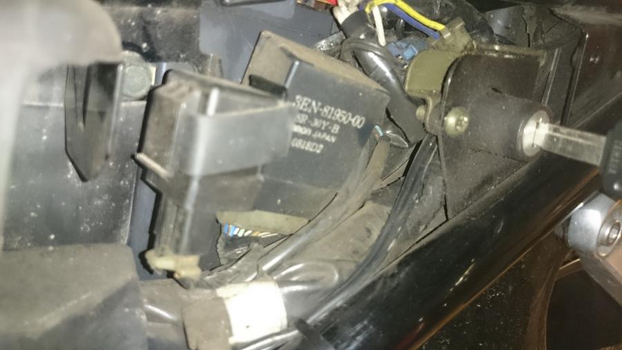

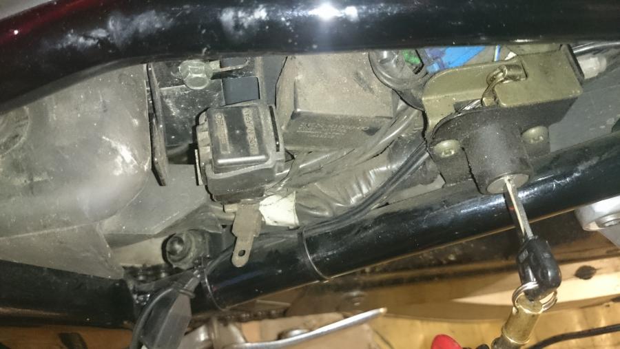

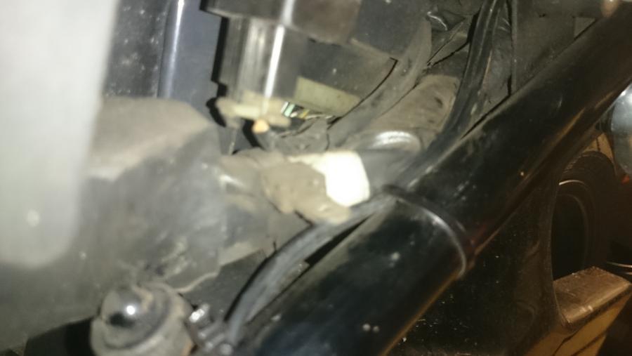

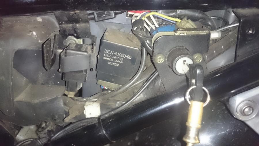

Re: Cable routing..... - sinto607276 - 16-07-15
Does it not show in the manual? I'll take a pic of mine tomorrow to help you anutz Smile
Re: Cable routing..... - anutz - 16-07-15
Thanks Sinto - it does but its not clear to me - if you can get  a pic of the side like i have as well as the way the cable is tucked behind the relay or however it is routed at the relay that would be great, no rush....
Any good anutz?
i think so....
the first pic, at the top above the yellow/blue wires, is that the starter motor wire curling in to the top of the relay, any chance u can snap that, i want to see once it has ran along under the relays and up does it snake back onto the relay?
(16-07-15, 10:41 PM)unfazed link Wrote: Page 8 of the 2000 supplementary manual shows it well but you need to up the magnification to about 300
It is routed strangely from the terminal nearest the battery.
Just checked mine and it is out to the left and down about 40mm then back and up the same height then down under the harness and inside the frame clipped to the harness on the way to the starter motor.
See, clear as mud, will try and get a picture tomorrow evening if you cannot follow the clear as mud explanation above :lol
I'm confused Sad
Anutz posts a quotation from you before you've posted it and then you make it really clear as to how the wires go :lol and to add to this, I don't have the relay to the left,  this isn't fair! I want one of those,  what's it for anyway?  :b
(16-07-15, 10:20 PM)anutz link Wrote: i think so....
thanks sinto
Need to be tomorrow now anutz, I just ran out to garage to get a few snaps for you to try and help,  in bed now matey :rolleyes

(16-07-15, 11:30 PM)anutz link Wrote: is that not the sign for a Diode?????
So......back on topic, aside from the potential that its an anti-gravity relay, it does have a diode sign on it?
Re: Cable routing..... - sinto607276 - 17-07-15
What year is your bike anutz? Mines is '98, doesn't have one, intresting to find out what it's for Smile
Re: Cable routing..... - anutz - 17-07-15
Its 2001, the supplement manual says its a relay assembly....really helpful, unless its a big diode that is there to prevent the reverse emf of the motor causing issues to something else
I don't know and now I'm more confused :b (than normal)
Re: Cable routing..... - unfazed - 17-07-15
To suppress Sintos confused state :lol
It is the diode for the Neutral Light circuit, on the 98-99 models it is under the tank and on the foxeye models it is integrated into the Starter cut out relay and the 2000-2001 models it is as you see in Anutzs picture Smile
