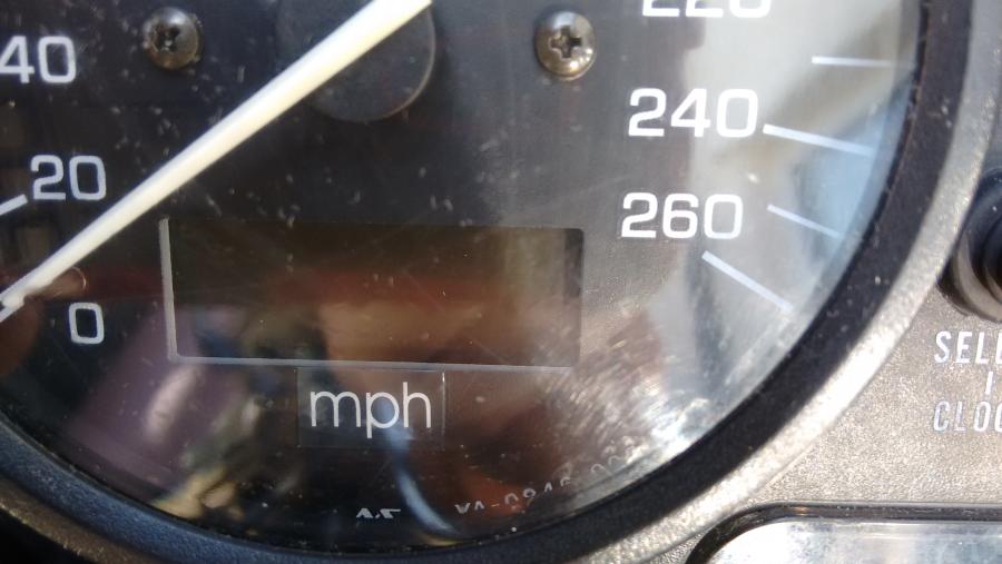

I'm a bit perplexed. I pulled up next to another Fazer today and noticed it it had a different speedo to mine. Mine has a 260mph speedo. The other Fazer had a 260kph/160mph. Mine has no kph scale. Is this normal?
Re: Is this normal? - Paulfzs - 30-06-15
notice your "mph" sticker that is covering a kmh print.
it will have a speedo healer built in to take it to mph.
Re: Is this normal? - clayt74 - 30-06-15
Or if it doesn't have a healer fitted, you have been riding very slowly lol.
Re: Is this normal? - BBROWN1664 - 30-06-15
:agree
That is the speedo off of a European bike. Your bike may be a parallel import rather than a genuine UK bike or the speedo may have been changed for a euro one.
Re: Is this normal? - fazersharp - 30-06-15
Yep definitely a MPH sicker over the KPH

Re: Is this normal? - 7omly - 01-07-15
Around 60mph at 5000rpm. The good news is I can simply replace it with a genuine UK speedo? Anyone got one going cheap?

Re: Is this normal? - BBROWN1664 - 01-07-15
7omly - There will be a box of tricks somewhere between the sensor and the speedo to make it read 60 instead of 100. You will have to remove that if you fit a UK speedo.

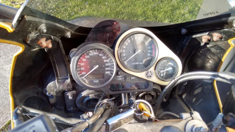

My bike is a 2000 FZS600S with the time clock on it.  I thought of buying the dial  but was too keen on taking off the speedo needle. If I buy that dial will I have to remove the speedo healer. At 70 my needle is only one third of the way round the dial but on UK bikes 70mph is almost half way round.
Re: Is this normal? - Paulfzs - 02-07-15
the healer is just a box with a plug on it.
get a decent set of pliers on the needle itll be fine
Re: Is this normal? - 7omly - 02-07-15
Thanks for the advice. I'm now unsure if the clocks are even off the right bike. Mine have odometer, trip one, trip two and time clock respectively when you press the top button. However I've seen what I assume are later boxeye clocks with a separate LCD display at the bottom of the rev counter. The more I look into it the more confused I am.
post a picture of your whole clocks.
Re: Is this normal? - 7omly - 03-07-15
Here are the clocks on the bike.
